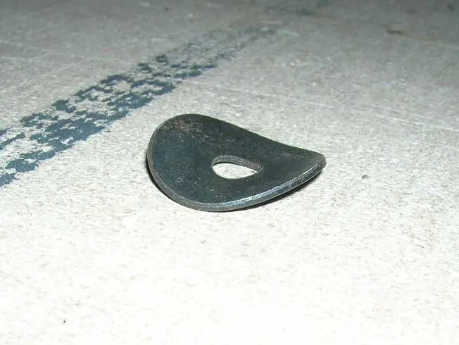

Here's a photo.
most of the tensioner mounts are a little to big to mount and hold tight to frame. cupped washers can be purchased at any hardware store and Way better than tape or rubber to hold your tensioner in place.
You can use 'em on either side to offset the tensioner a little too.
