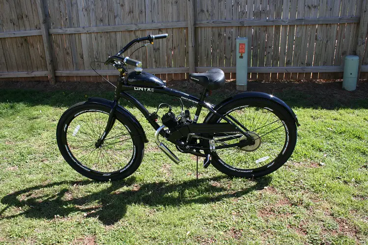

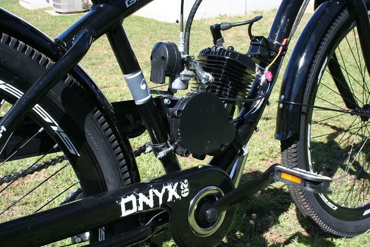

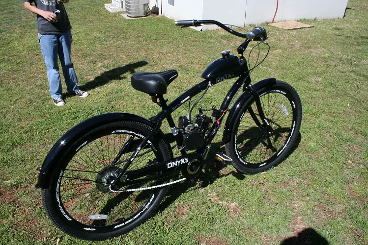

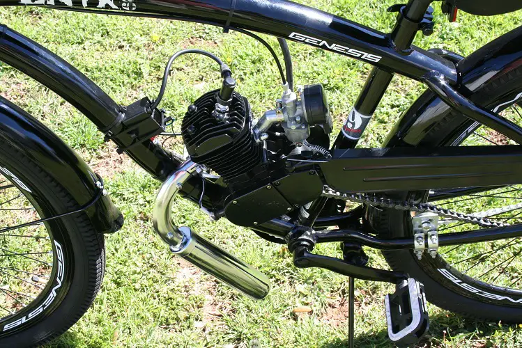

I have read a lot about just how bad the Walmart bikes are. Well I have built about 50 Walmart bikes so far. From the Cranny to the Genisis 29er. It is true that they are not the quality of some bike shop bikes that you pay 400-500 bucks for. The average Joe that I sell to can`t afford to buy a bike like that from me. I still believe that you build a good bike the right way and you will get a bike that will work for the average guy.
Now to the point. I have built 5 of the Genisis Onyx bikes. I love the way these bikes ride. I am only 6` and it is a little tough for me to get off and on but it is a wonderful ride once I get on. These things will cruise nicely around 25-30 mph. They are also very smooth rides.
I also build bikes part-time at my local Walmart and I can say that not all Walmart bikes are thrown together!! Some of us do have a little pride in our work. So between building for Walmart and running my little business of bikes at home, I see a lot of different bikes. I have seen some expensive pieces of crap too!
Here is one of the cheaper Genisis Onyx`s

Nice Bike! I love the big fat tires.

Yeah,they make for a nice ride.

Nice work on the bikes Don! I like the little trailer you build, really sharp!

Your bike looks good, but don't forget to either remove the ball from the spark plug, or replace the spark wire with an automotive one w/ real boot. The chinese boots are the strangest thing. When the rubber dries out they will start missing and arcing because they don't clip the spark plug tip (ball shaped).
How did you do the front mount? It looks like the kit mounting hardware, but the tube looks fat.
