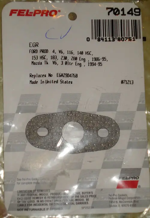

This one works really well just coat it in a little rtv orange wand it's sold at most auto parts stores make sure to match it to your exhaust port use fine snips with a fine tip
and it's under $3.00
