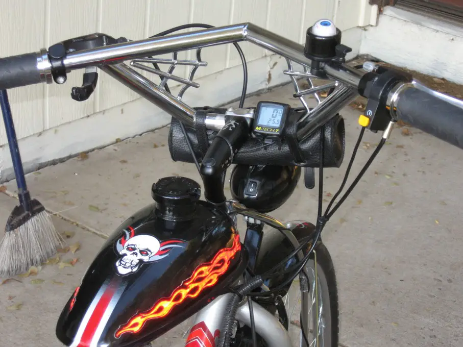

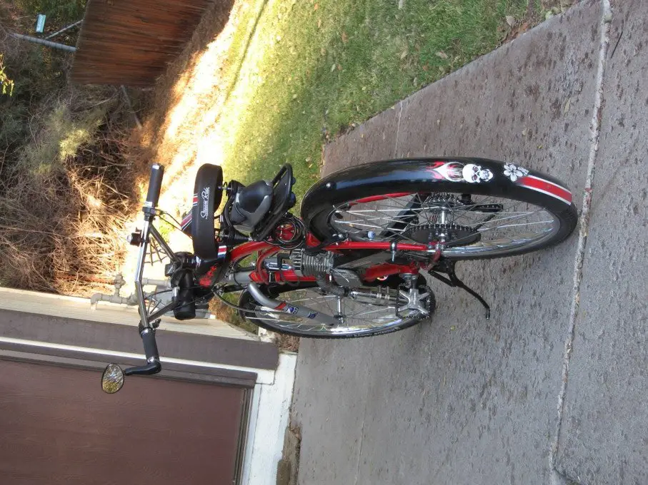

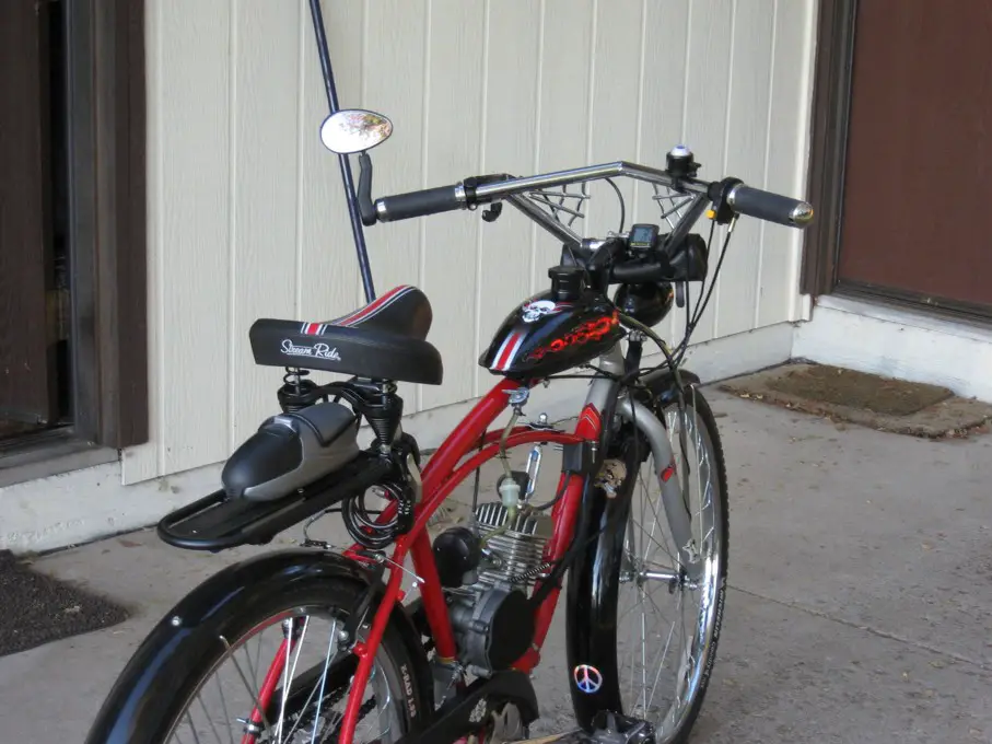

here's is a few pics of my schwinn...5 months into this...starting a new one...
sorry for so many pics but I just learned how to send pictures...thank you

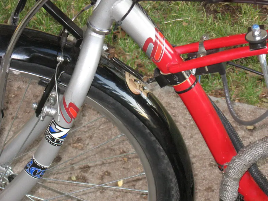

nice looking bike
is it a point beach?
what is the spring by the cdi for?
so many ???

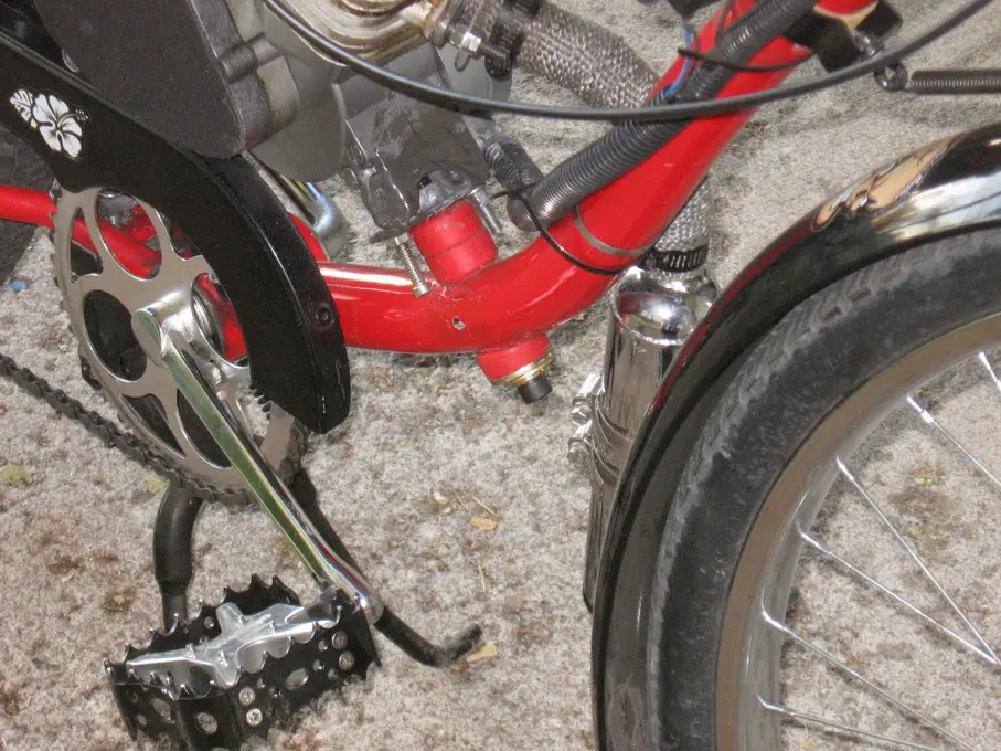

Default Re: my schwinn...
Offerber, I like the bike, looks like you will have fun. I can see a Shackle in one of the pics, what does it do? I was looking for a way to add a upper brace to my engine to stop some of the vibration. Is that what you are doing! Have fun, Dave

Originally Posted by justbill View Post
nice looking bike
so many ???
know, its a southwind 2007...i think...just got it...good crome moly...the spring acts as a steering stabilizer...keeps the wheel from twisting...you can do hand signals now...ha...take off from the hibie steering stabilizer from germany...hope that helps...bye
Those are turn buckles...they are great and i highly recamend them...i have one one the top and one on the bottom...if anything goes wrop...boken bolt or what ever they will hold engine in place until you get where you have to...when i was expermenting with the motormount lot of things happened out of the blue...your covered....holds you engine in tight...had to fabricate brackets...when i get time ill take pics and send them to you...bye...
