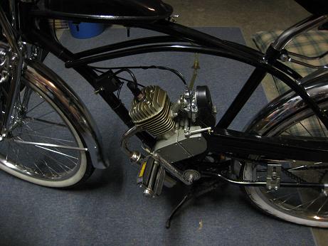

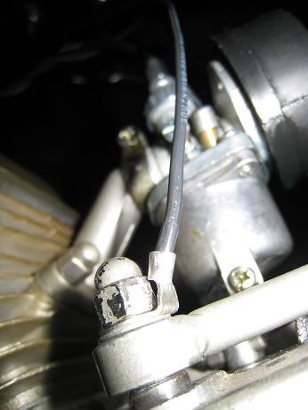

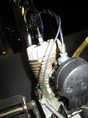

I installed my first attempt at solving the problem. Total cost = $0.86 cents. I talked to my brother-in-law who just bought a chinabike and he's having the same problem. I can't believe this doesn't bother tons of people? Anyhow, here are some pics.
It's really low profile, and basically involves a wire clasp that screws on below the clutch lever nut, and a short strip of copper wire with black insulation.

In any event, I seem to be free from pant leg lockups thanks to my $0.86 solution! I still think there's a better way though. Something to cover that nut or clasp onto it maybe.
