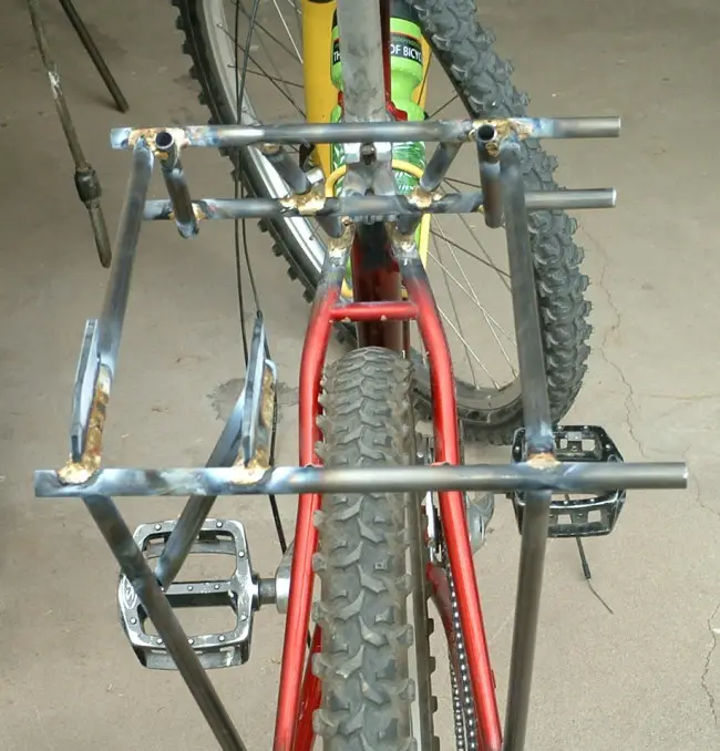

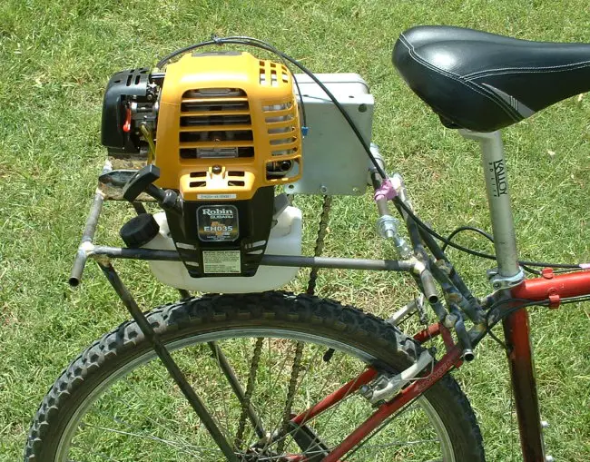

I cannot compare but if he says it is harder I believe him. Here is a photo maybe I can dig more up but am at work. I am a frame builder so it was not too difficult for me to fabricate what I needed. The gearbox sits on the left looking from behind and the frame holds it which holds the motor. the kit comes with struts that I would just go ahead and use instead of this setup. It is light as I used Cro Moly tubing and brazed it together.
