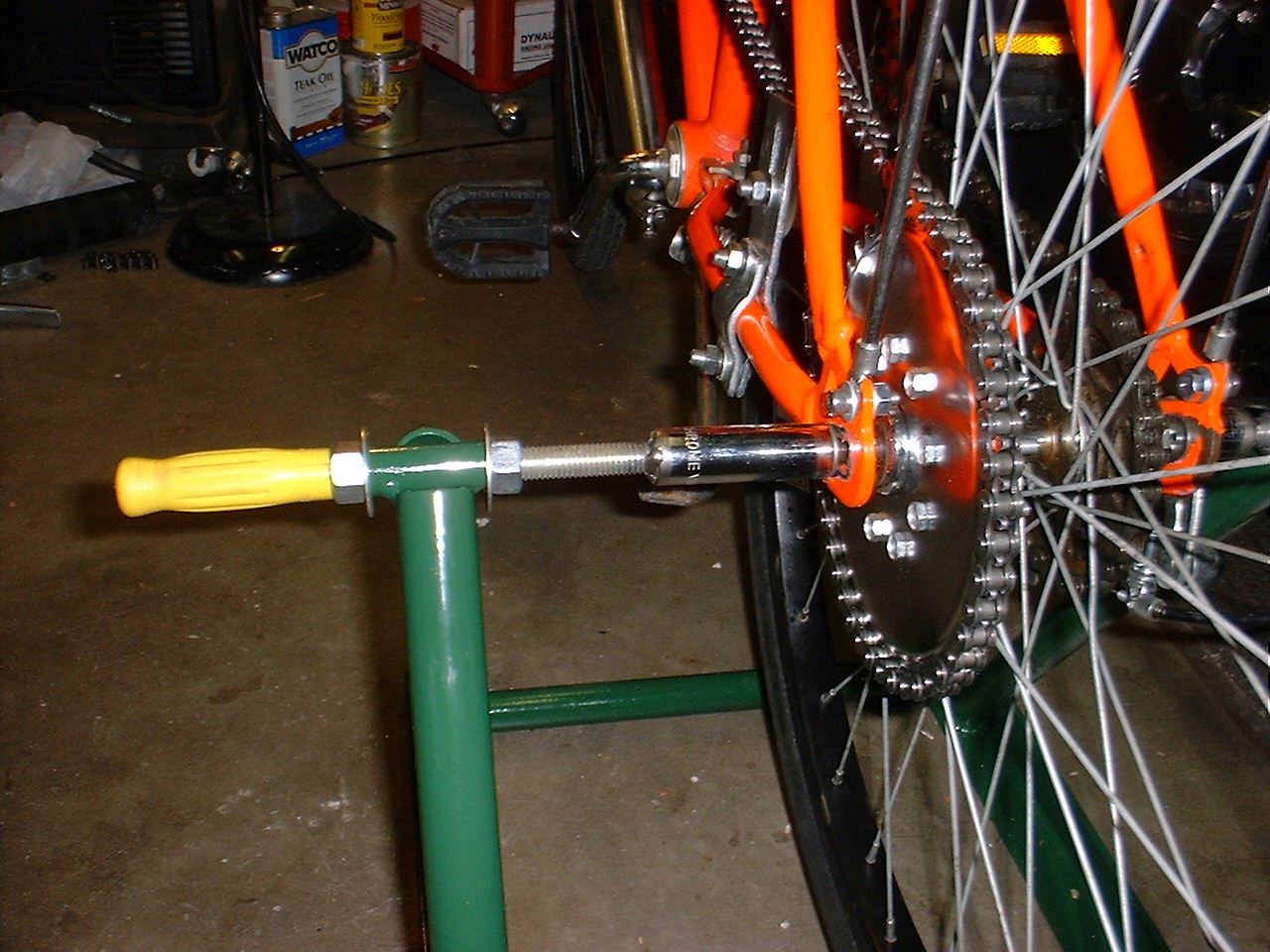

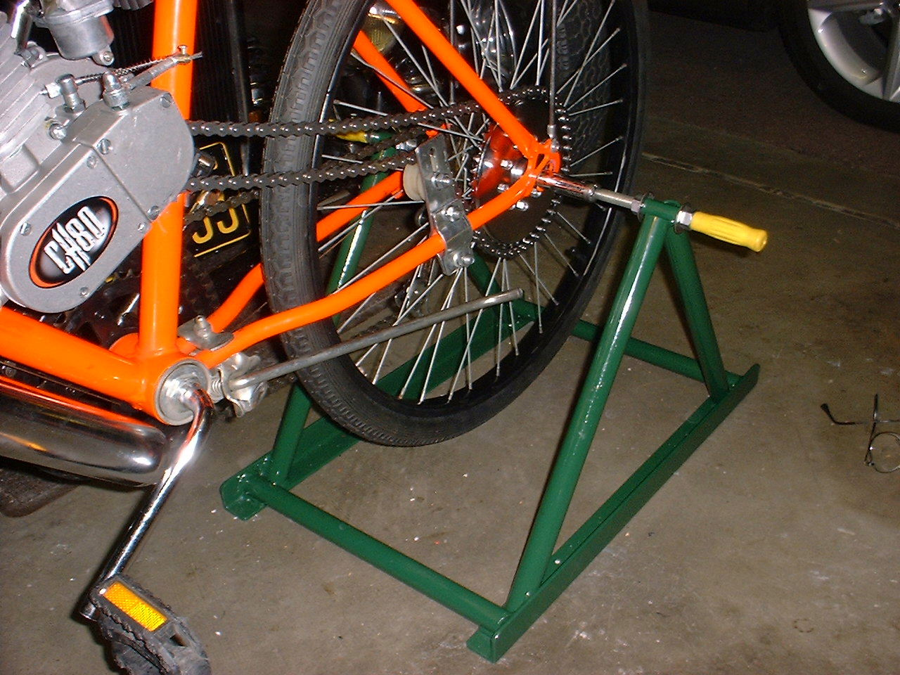

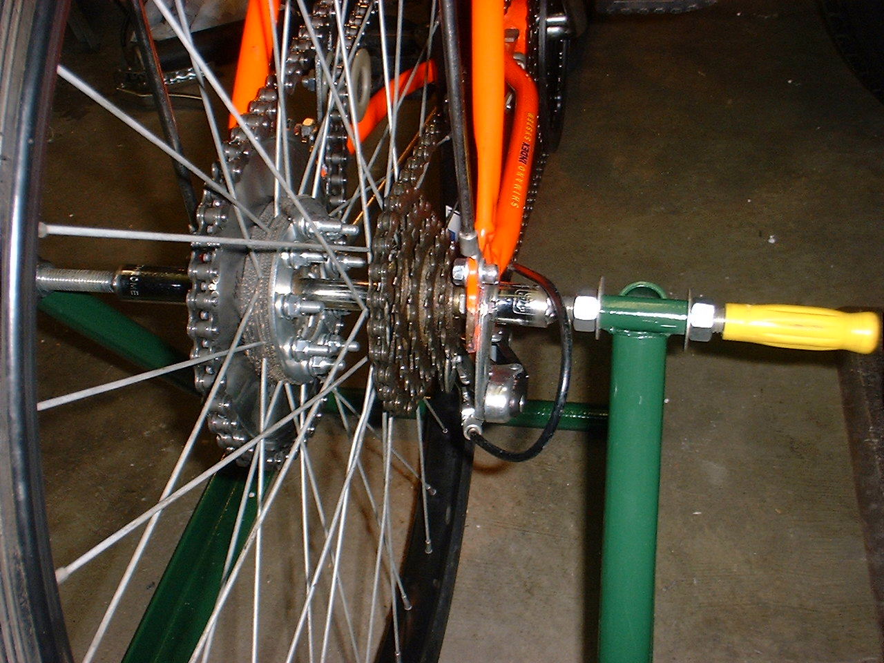

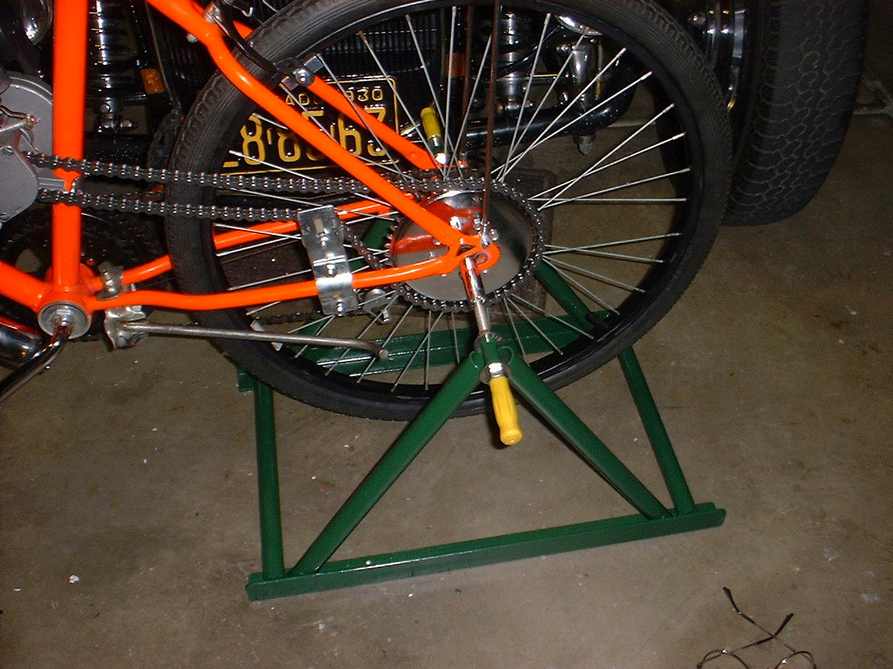

Just built one. No photos but I'll take a few tonight and try to post them here asap. Relatively simple project if you're a welder and have access to some angle iron and steel pipe. I used two 15MM sockets welded to 1/2" all-thread to lift and support the rear wheel. It's adjustable for any width front/rear axle and heavy enough to hold a small to medium sized motorcycle. I wouldn't put full dress Harley up on it but it will easily and safely hold a bicycle for engine runs and test and tune of sprockets, chain etc. Took about two hours to fabricate and cost was under $5.00

Here's a couple of photos of the work/test stand I built. I hope it is self explanitory but if not, just ask.

Looks good but I'm wondering if the bike is stable with just that, or do you need to chock the front wheel?

I've run the engine, clutch engaged and peddled it on this stand with no wobbles or shaking. But...I always aim it toward the garage wall and not my wife's car.
