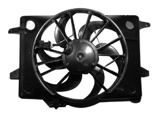

what you can do is drill about a 6in hole and install 2, 12v pc fans from radio shack ,one under the seat bringing air in , and the other one in the back taking air out, that way air can pass through the box

I couldn't bring up the photo you posted so could't see the box. What about some kind of air scoop to direct air through the box while moving and have an "exhaust" or exit point to the rear for the scooped air to pass through. While stopped for any length of time you'd need to think about the electric fans... maybe and maybe not. You'd have to try things out to see if the engine was overheating.

yea other ppl isee with motor bikes have the 66cc/80cc motor but i think my bike will blow that motor or i wont go fast i had anther idea but then i saw what happens uphill soo idint like it it was a friction motor and fans Ohh man do igot those 6'' fans i got clear ones blue ones black ones im a technician and i have alot in my inventory but yea i was thinking of a a oiled coll hookup i was thinking of this but ithink its a lil too much for this project (not in price) OILCOOLER like ised its going to be a winter project to keep me bussy but i was thinking of taking a 10'' sub out in the bottom and getting a peace of mdf wood and put it there and mount the motor on the peace of wood where the sub wood be but i can also get my hands on a 49cc 2 stroke gas scooter motor with a generator and keys for same price (but ist the 2 stroke a gas guzzler for bikes)?
