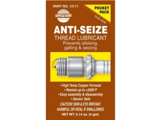

AutoZone. They oughta know what you're talking about, and they have it in little packets at the counter usually.
I can't believe the motorcycle shop didn't know about it, but they may not use aluminum-head motors much...

If I went into a shop and they had no ideal what anti-sieze is...I would turn around and exit as fast as possible and never return!!
ID:	2430   Click image for larger version
ID:	2431   Click image for larger version

On a more serious note - you only need a little bit. I check my plug fairly frequently so I certainly only use it with a new plug.
I have Al paste, Copa slip, Nickel, - but the best for plugs? The little stick kind. It's Aluminum in semi solid "crayon" form. Not messy, easy to apply.
Again - too much or on the tip and you'll foul the plug I imagine.

Copper Antisieze is cheaper but I use Aluminum Antisieze for its improved corrosion resistance. I ordered mine from McMaster-Carr along with enough threaded rod, bolts, washer, nets, gasket material, and a bunch of other stuff to set the engine up the way I wanted it.
