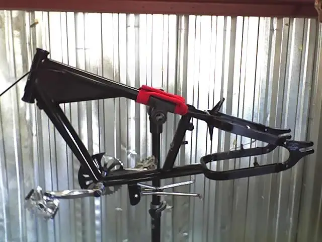

Yeah, I'm in the middle of an OCC Chopper build right now too.. Livefast sprocket adapter worked fairly easy. Barrys motor mount went on fine. Installed the tank with the supplied brackets upside down. Attached them to the frame with threaded 1/4 20 nutserts.
Exhaust is what has me worried. I'm going to hate spending the $$ for a custom chopper pipe.
Started this one from a bare frame..
