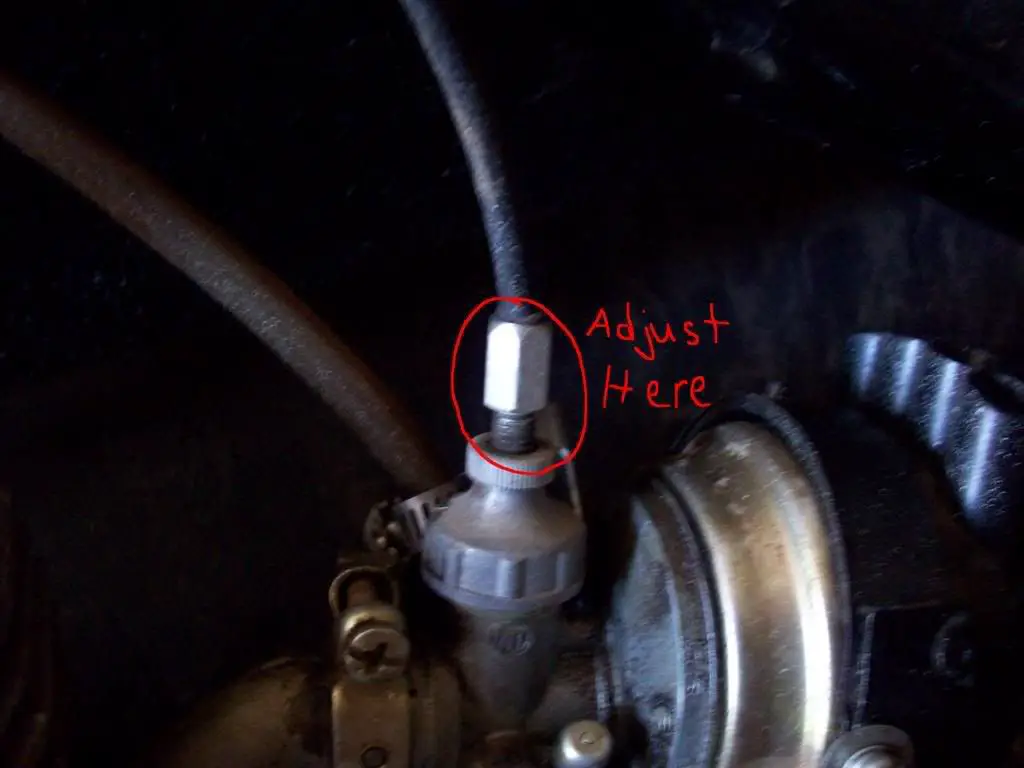

I got a question. It has to do with my throttle. The instructions that came with the kit weren't very clear (kingsmotorbikes.com). I have a twist grip throttle but the throttle is loose if u know what i mean. like there is no spring in there, it just spins. Also I don't know how to put the end of my throttle cable inside the carborator valve. And what is the other wire for? i'm guessing it's the kill switch but I don't know where to put it. It's shaped like a flat metal circle that looks like it's something electrical.

Sounds like to me you have to much slack in the throttle cable. You can adjust the throttle slack on top of the carb.
ThatsDax has some pretty good instructions on installing the throttle cable

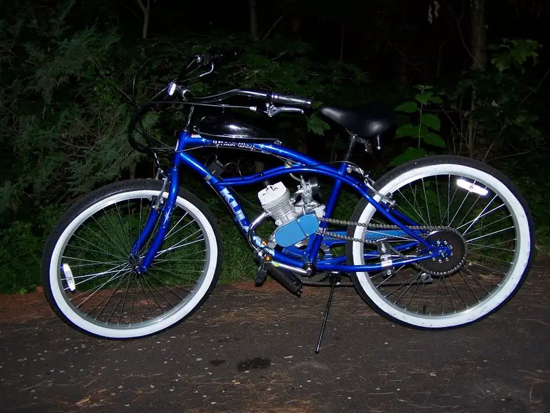

Here's mine and I love it, especially the handlebars.

Very nice !! Awesome Build !!! Enjoy that ride !!!
