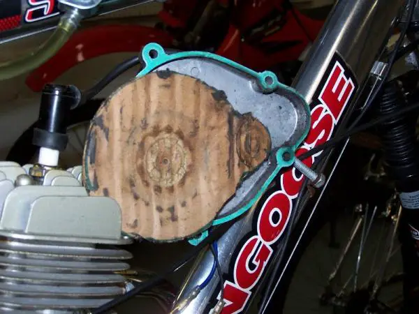

whine/squeaking your hearing Is the cheap China Gears.
You can try different Things ..Gluing Mouse Pads Over the cover .
But
One of the best easy fix i do is .It wont fix in Completely BUT you will hear a noticeable improvement.
Here at Blue-Collar ..We call it a clutch Muffler
Take the 5 screws off the clutch cover Lay on a cardboard box.
Trace the outside of the Clutch cover and cut the inside of your trace.
Place inside And tighten all hardware. It will not do any damage or soak up grease from gears.
I have been doing this for over 6 years with pretty good results.
What your doing is taking up space the gears have to amplify the gear sound.
Sort of like A drummer Putting a pillow in a drum head.
Hope this helps.
Cheers
Bob
BlueCollarBike
But
Hope this helps.
Cheers
Bob
BlueCollarBike
I tried that inside noise damper. My clutch rubbed.
It damaged my clutch pads.
It is much safer to glue carpeting, or ghost0,s material to the ourside of the cover.
Also glue some one inch long pieces of fan belt or old sparkplug wire between the cooling fins. It does wonders for noise reduction.

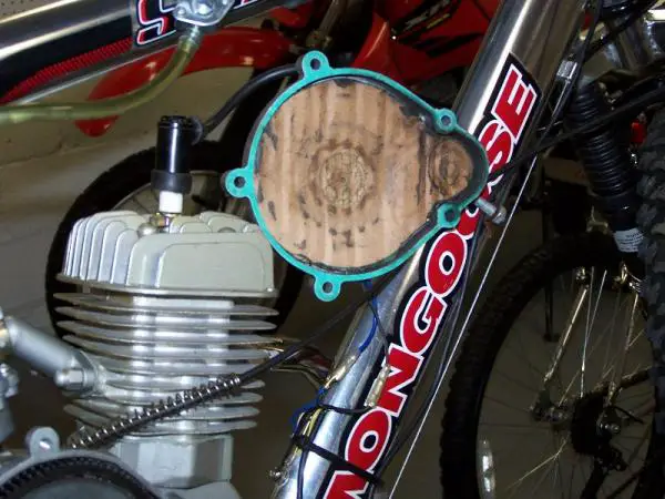

http://motorbicycling.com/attachment...ch-cover-2.jpg
Very hard to believe to say the least.
Simple paper ( cardboard) destroying clutch material ?
I have used a single piece of Cardboard In ALL my builds for over 6 years now.
( believe me I have built allot of bikes)
I have had not one Show ANY sign of any problem using the Cardboard I( paper) on the inside of the Clutch housing
Using Card board is the simplest easiest Most effective way i have found thus far to cutting down on Clutch noise chatter.
You can see by the Picture the amount of clutch surface to housing interference.Its almost Nothing.
You may want to review your clutch ,,,There may be more going on if your saying A single piece of cardboard ( paper) has damaged the Ht clutch.
cheers
Bob

I was not being clear .
I did not use cardboard.
I used a plastic material coroplast
There was not enough room in the housing for the clutch and the coro.
Your photo shows the clutch is contacting the cardboard material.
Ahh.
Now it makes sense.
Yes the cardboard ( corrugated paper clutch muffler ) will come in contact with the Steal clutch plate ,it will simple squeeze the Cardboard making A permanent harmless impression.
the Steal Clutch plate will have absolutely no ill effect
so no worries.
As you can see by the Picture that is the worst that will happen in a 4 year period.
Again the Cardboard ( Clutch muffler ) is the easiest and simplest solutation to effectively decrease the clutch squeal.
hope this helps
FisherMan welcome to the fourm.
cheers
Bob
BlueCollarBike
