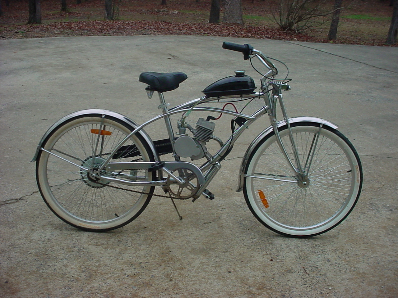

Default Re: striped bolts
It's a good idea to use a JAMB nut when screwing the new studs in. This way the go all the way down and seat. I left the jamb nuts on once they were all tight just for extra hold. Just my 2 cents.
