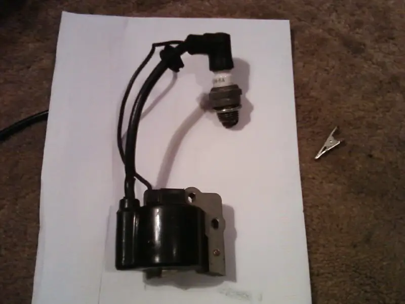

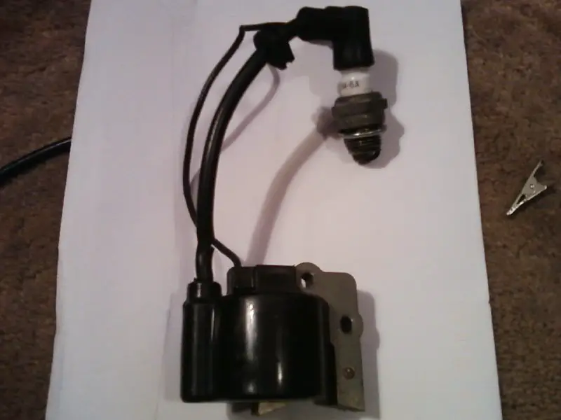

I just checked and it looks good, will just need to drill one hole or poke out the aligning stud where my hole should be. I am also posting a pic of this thing so you can see. my buddy here says I can not remove the aligning stud with out it falling apart, I say this stud was only used during the manufaturing process and no longer serves a purpose. let me know what you think. Jim...

It looks pretty close to me. I wouldn't knock anything out till I tried this one to see what needs to be done. Worst comes to worst hand on to everything till another one like it comes up. I think this came from a craftsman but to be honest If it gets close enough to get the charge from the mags it should work. I am going to send it on hope it works. Give me your snail mail in pm and I'll send it out on tuesday.
