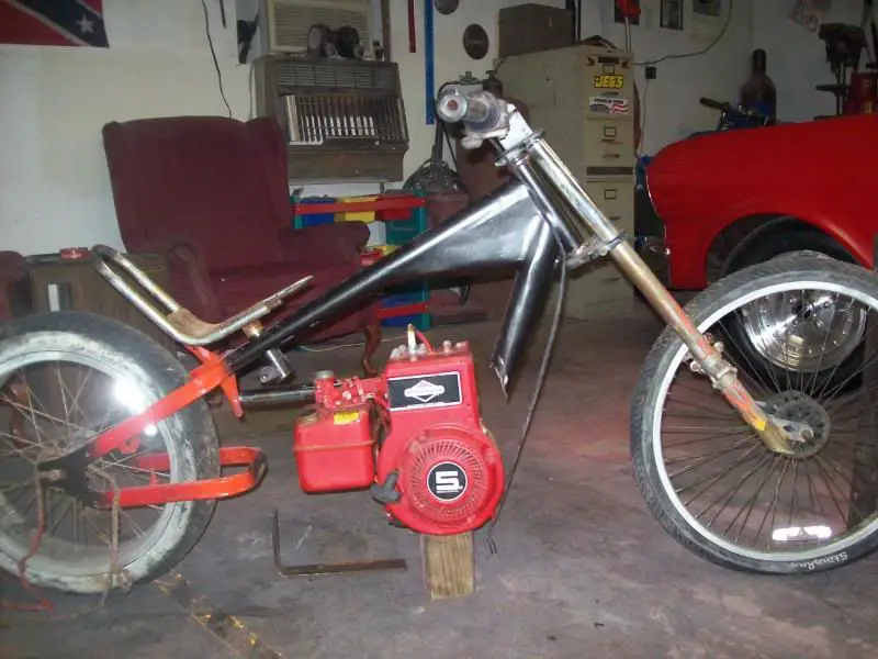

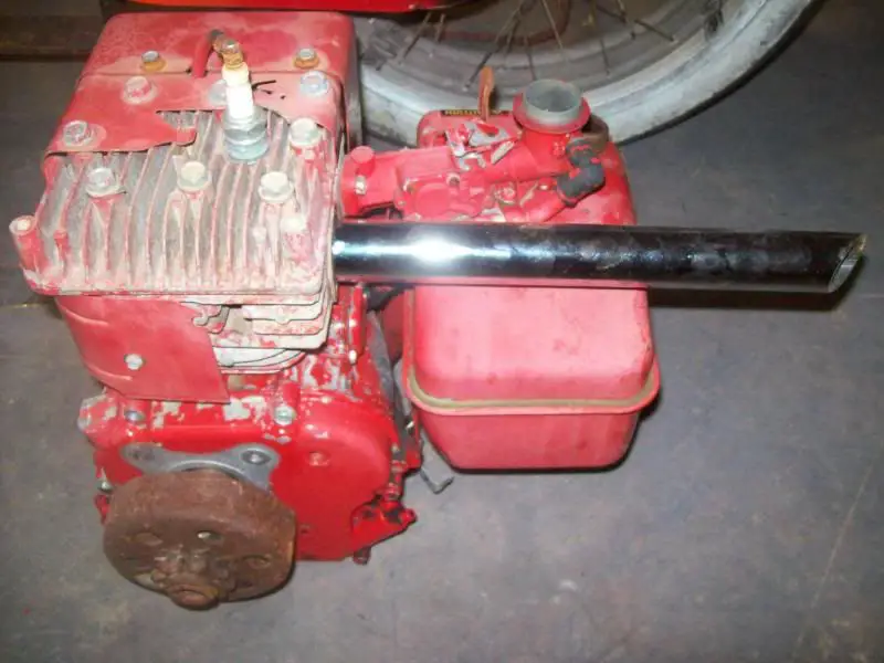

Hi Guys, got an occ chopper frame with a 5 hp B/S. Do I need to offset the motor to one side so the clutch and back sprocket line up or center engine and use jackshaft to swap chain over to other side. as clutch-chain-jackshaft-chain- sprocket. thanks Joe
With this picture, and there no pedals showing, then I think you’re doing a motor bike without pedals?
I have with my new build which is without pedals and meant for the dirt, made my own clamp to spokes with pulley and v-belt. Then jack shaft and gear, chain, and clutch.
I have not ever used the gear that is part of the original part on the rear wheel. The gear is small and that makes for too high a gear. Possibly someone out there knows if it can be used along with other gearing down on a jack shaft to compensate?
The offset that would be required with the engine shaft on opposite side to utilize that existing gear would not make sense to me, too much off balance.
I made a motor bike with engine offset, but I had the pulley on the rear wheel as the same side as the engine shaft. Once I got going it was not too bad, but the engine had one side interfere with the foot peg and comfort.
The jack shaft with gear & bearings can be purchased for around $25.00 and I got one and used both welding and bolts to set it up.

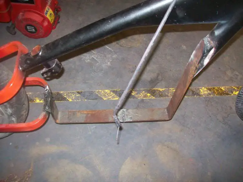

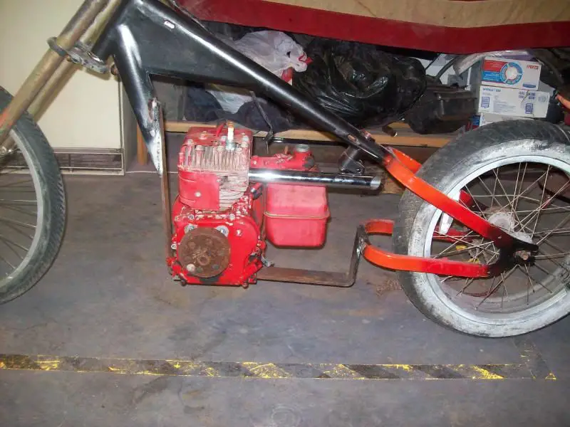

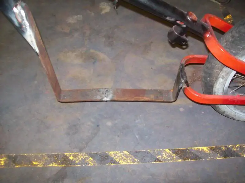

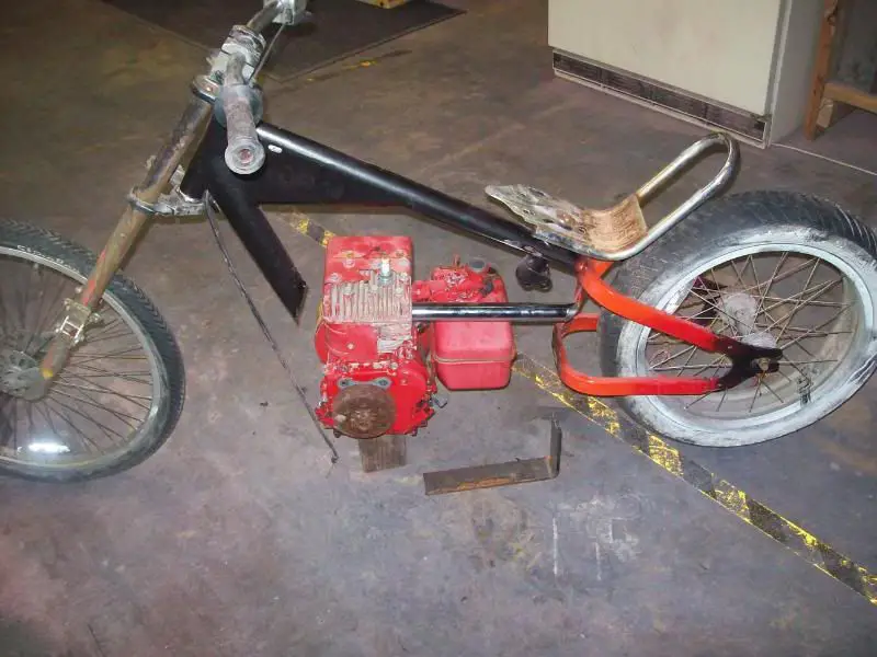

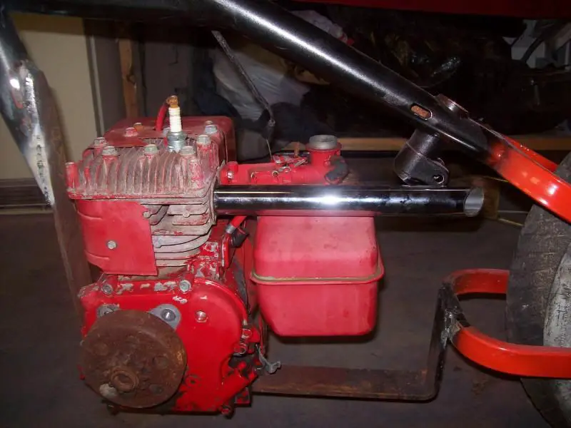

Hi guys, acouple of updates. got part of the welding done and frame connected. Got my welder in the shop..It was not doing to well, needed a tune-up. Got motor mount plate on the way. Still confused on how to run the chain to the rear wheel and on how to get it to stop. the steel I used is like a 1/4 in. that was prebent. Some kind of motor mount from work Joe
