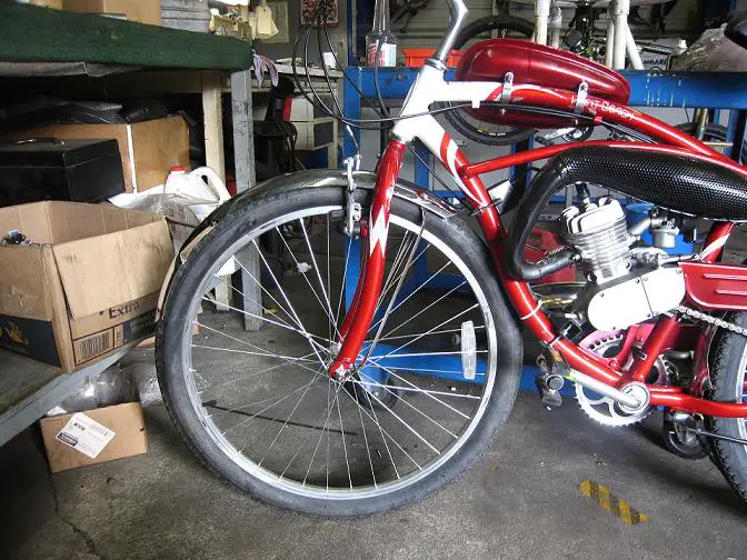

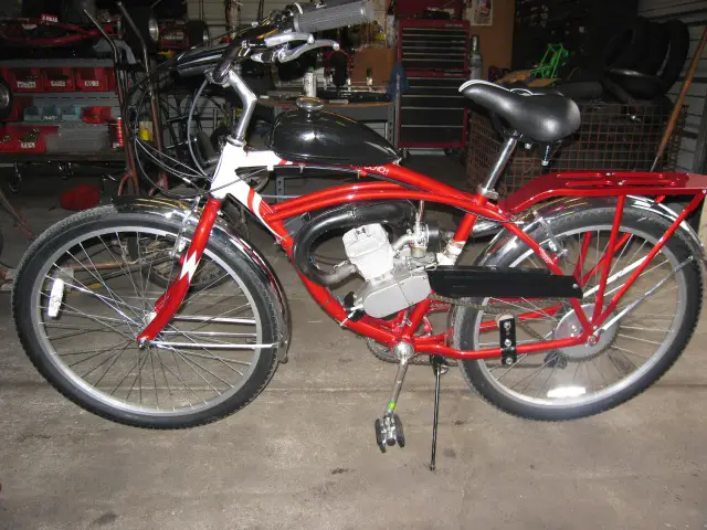

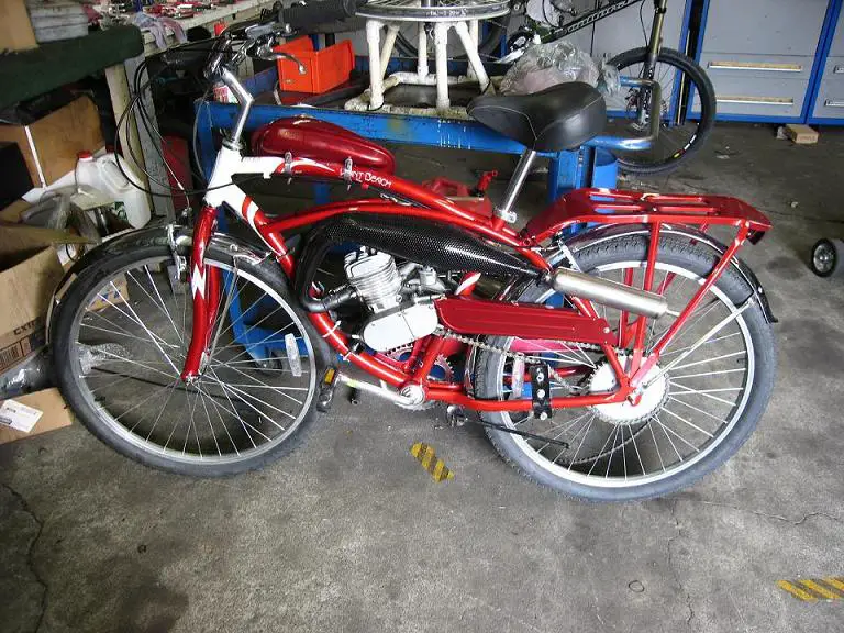

this WAS a beautiful Schiwn Cruiser. My buddy was riding home and he said he was only cruising around 20-25mph and the fender tab that attaches to the forks near the brakes snapped off. Before he relized he was on the ground. I'm glad he wore his helmet that day. I've noticed on my bike that speeds over 32mph my front fender vibrates like a S.O.B. Also I know (just like everything else in the world) some factorys don't build bikes like they use to.

Did you noticed that the front tire locked up so bad that it bent the forks?

I'm banged up but for a different reason. But my friend snapped his collarbone and broke 3 ribs. I saw him today @ the races and he's pretty banged up.

Hi Gang, I had wanted to comment here, but things have been very rough here.
Ok, no here's the drill, IF your bike has ANY part that shakes like a wet dog, STUDY that part, and determine what action will reduce, or even stop the vibration.
I have seen several of these types of bikes damaged in exactly the same manner as this one, and ALL of the riders were pretty banged up in the process.
Believe it or not, the very first such front-wheel fender fiasco I have seen was none other than Steve Miller, of SpitFire, probably 6-7 years ago, in his case it was a fender brace, cracked at the point where it went fromn the stamped shape, to flat, and, as it let go, it skewered the front wheel, and he was end-over!
4 years later Carl at about 73 years old, on the very first of Grube's 4-strokes, had a brace give way, skewering the wheel, lauching him over the bars, took 3-4 months before he could ride again, the bike was toast, kit was OK.
WallyWorld sold some cheap Huffy's, I forget the model, and I saw somewhat less than 5 of those turn into catapults.
The bike in the picture COULD have been saved IF, as Noogoodnic says, the L-bracket were replaced AND that a second front brace were added.
I will NEVER do a motorbicycle with only one true brace on the front fender.
Mike
