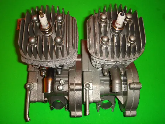

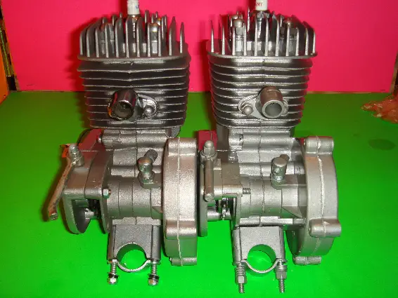

NOW the meat of the matter....The engine itself.....
A quick glance, shows the finish on Blue Collar's engine is shinier than Dax's flat cast look....Maybe the factory used clear finish?....Blue's is probably easier to wipe clean because it is "smoother" but will this hurt heat dissipation?....Maybe a little but not enough to matter probably....
Dax's engine uses a longer clutch pull lever....that is a plus....leverage makes working the clutch a tad easier....plus the nicer clutch lever mentioned earlier to boot...

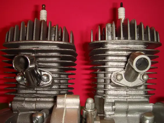

Dax has a chromed intake BUT more importantly it measures nearly 16 MM ID vs Blue's 13.5 MM ID....Hands down Dax Inhales better (I did NOT take the intake off tho to see the actual size of the cylinder port opening tho).
Not readily seen in the pics BUT Blue's head gasket looks to me to be
about 3 to 4 times the thickness of Dax's head gasket.....Can you say easy compression increase by simply thinning the gasket ?!?!?....Hmmmm....uncork the torque!...Of course I didn't measure compression so hard to say what the result of thinning the gasket would be....(instructions say stock compression is 6 to 1).
Cylinder - Dax has the top three fins that are a little larger than the others....Blue's cylinder doesn't ....Although the additional sq. inches of cooling fins may be nominal it theoretically can give a little better cooling due to additional surface area....Not a lot maybe but possible that every little bit counts....But then again it is probably so nominally different as to be inconsequential....

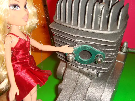

Exhaust port - Blue wins Hands down here....Huge area for the spent gases to exit...Much larger than Dax.....Nicer gasket too BUT the gasket is NOT perfectly matched to the port opening and since it is metal covered it will have to ultimately be tossed if one is to match the port to the opening of the gasket.....Of course ALL this is a moot with the stock exhaust since the flange on the exhaust is smaller than the exhaust port of the cylinder.....Can you say "Dremel time"....

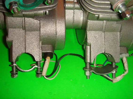

Front Mounts - The Front Mount on Blues engine will accommodate a larger frame tube than Dax's (Blue has a larger opening radius)....that can be a PLUS or MINUS...Plus in that it will already accommodate a big tube BUT if the down tube is small there will be a gap....You can always File a Dax to fit....Although a little more work is possibly involved Dax get's the nod here at least for the smaller down tube equipped bikes...

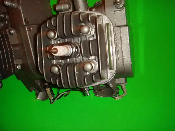

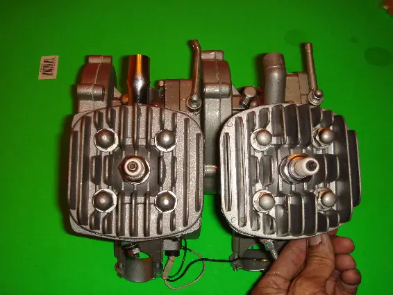

Heads - Externally Blue gets the nod here for the larger reinforcing ribs on the "dome" by the spark plug (see pics)
Beef of block - Looks about the same But I like the Dax here because of the
extra metal around the clutch lever opening, and the extra metal where the bolt goes through to hold the engine halves together (under the exhaust port)....Probably not of any real significance but it is a detail.

The dolls are a nice touch as well.

thanks for the information it says a lot about the engines truly not all coming off the same line, but I wonder just how much real world difference there would be to a buyer of either engine.
They seem to all be the same BASIC design. A little different finishes and maybe the qc is better one place than another but unless I saw it being done I might be inclined to call that hype by the factory.
But then heck, I build weedeater bikes what do I know.
Old 08-29-2008, 06:06 PM
Bikeguy Joe's Avatar
Posts: 10,853
Default Re: Ready to Rumble....Blue Collar VS Dax!
I think the shiny-er finish is paint. I have one engine of unknown seller that has a nice silver finish.
Nice to know the intakes are that much different. I have both, but never really paid any attention to them. In fact I thought the cast one looked better...

Looks to me like the drive sprocket on the Dax sits out a little further from the mount.If so it would be a good thing in the case of wide tires.Ron
