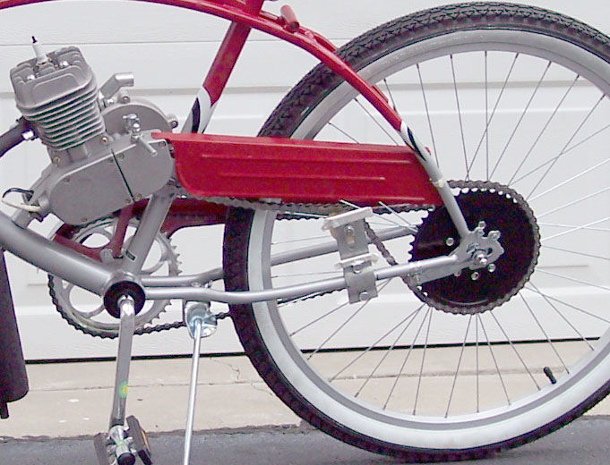

Hi,
my first post here.
I just bought an engine kit off ebay from boygofast.
an 80cc kit. (I know it is probably -70cc)
the chain pitch does not jive with the rear sprocket pitch.
(it appears that the chain would need to stretch considerably to fit)
anyone seen this before?
should I buy a new chain? what size?
or buy a new sprocket? if so, from where?
thanks!
steve in frederick, md

just wondering the chain appears to be seating on the bottom side of sprocket do you have the sprocket parallel with the tire or perfectly centered on rear rim. that was the problem with mine when i first put together

I took the sprocket to a motorcycle shop today to try a different chain on it.
a 420 sized chain fit the pitch of the sprocket perfectly, tho a 420 is quite a bit wider which is not good.
anyone know of another size chain that has the pitch of a 420 but is narrow in width?
thanks!
-steve in frederick, md

Ok the coating on the sprocket is too thick. Dax says use a grinder to gently "buff" the plating off of it. I am never one to follow and took mine outside and found a rough piece of sidewalk. Scraped it till it looked good. Not much! just a little. Both sides.

#41 chain from the Tractor Supply Co. or other places is a perfect fit to the standard China In-Frame kits.

Also called #415 or #415H in the bicycling world.
