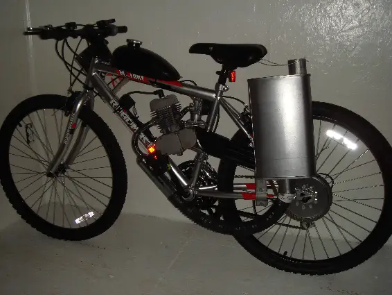

HI,
For quiet you can do this.....Large volume muffler means zilch back pressure for all practical purposes....Quiet too!
Andrew

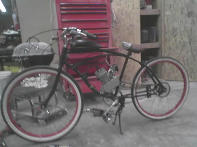

thanks guys. today i port matched the intake and ehuast, cut off the pipe connected to the muffler end cap and drilled the holes in the baffle plate out. it just started raining so i cant take any hot laps. i'll have to get back to ya with my progress.
