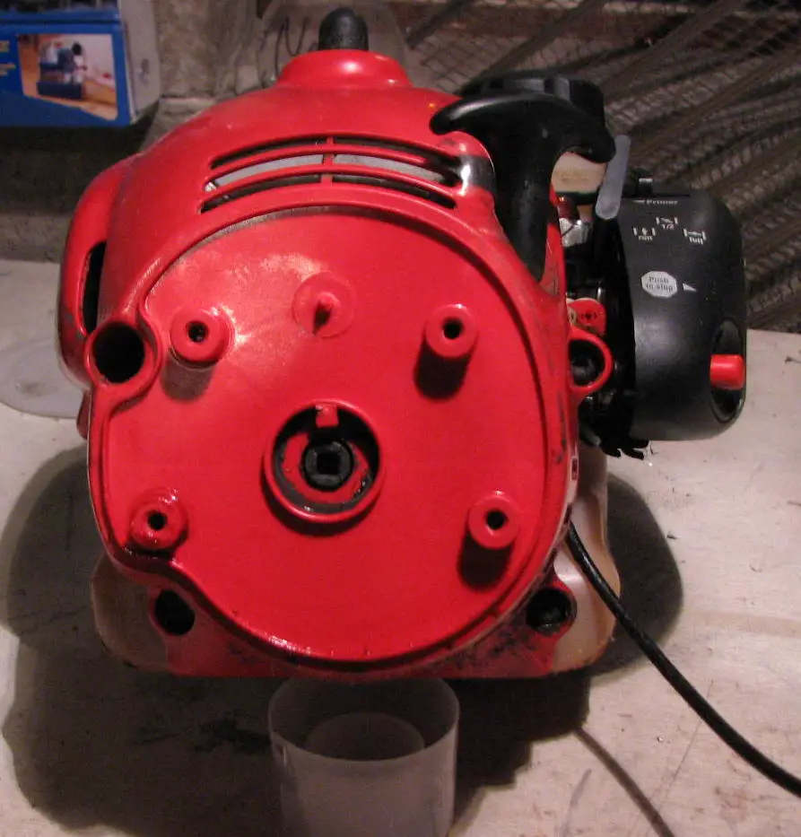

Some pics:

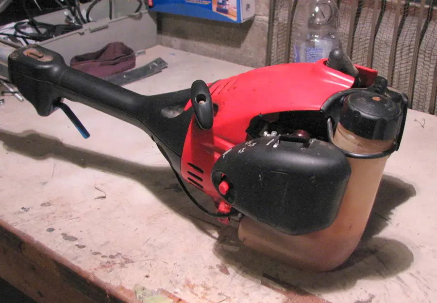

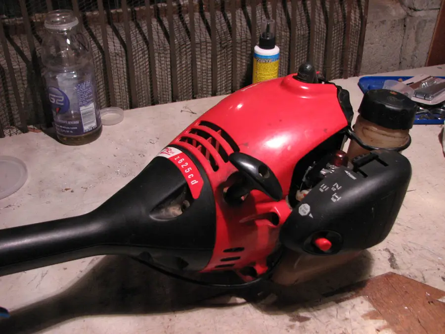

There are 4 screws to remove the boom/.shaft
then 4 more to remove the handle

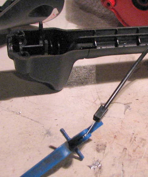

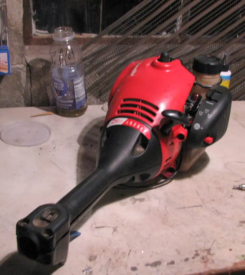

Getting the throttle out is easy, slides rightout.
the handle is held on by only 4 screws.
the whole engine i held to the handle by 4 screws and a length of flexishaft

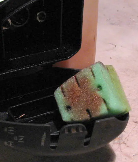

let's take a look at that air filter...
looks brand new.... sort of

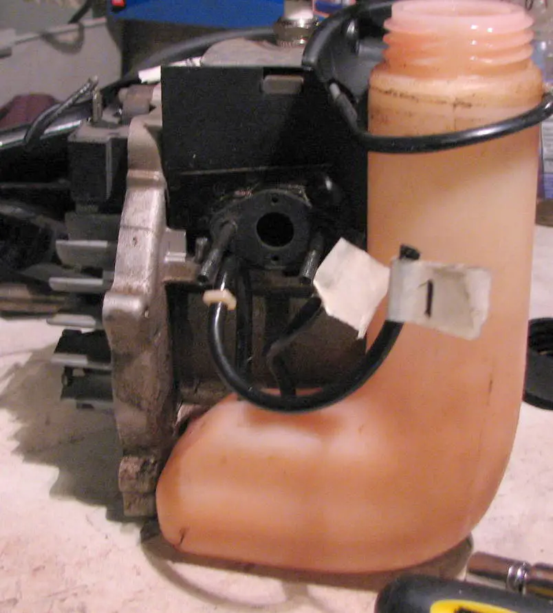

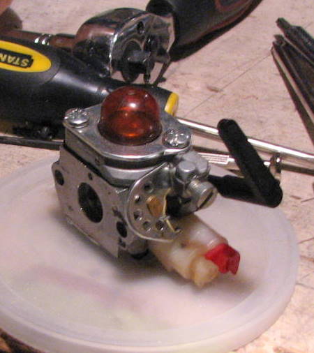

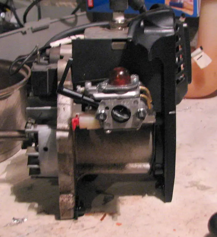

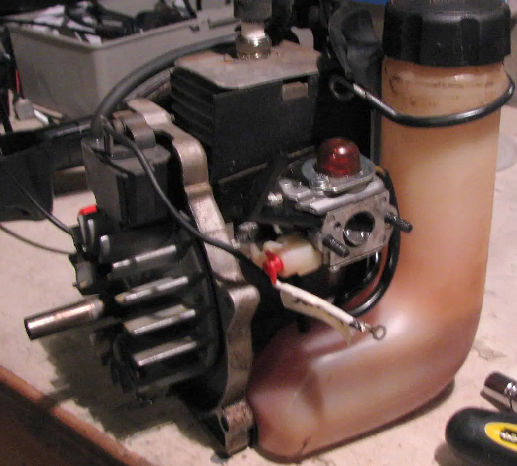

look at that cute little carb- probably the source of my woes

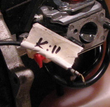

I label things in case I forget where they go- I realized after labeling this, it's the only wire on the whole thing, I probably WON'T forget it goes to the kill switch.... for which I will wire in a sweet new momentary switch
I also labeled the fuel lines: #1 inlet has fuel filter in tank #2 outlet...
Inlet port doesn't look bad, looks pretty clean. a little oil but over all can't complain.
Also all gas was poured out. It looked funny.... Really red, overly so and greasy as he!!. Not like the 2 stroke mix I've been using, my 2 stroke mix is blue green and never seems this greasy, even at 32:1 for the ryobi. When draining it I was going to throw it in my gas can and put it in my car... But after looking at it I don't want to, the car is nice...

Thursday I will take the little carb apart and see if there is crud in it, which is possible. I did squirt in some carb cleaner into it and I may see if I can get it running smoothly with just that. we'll see.
aww gee isn't that the cutest carb you ever did see?

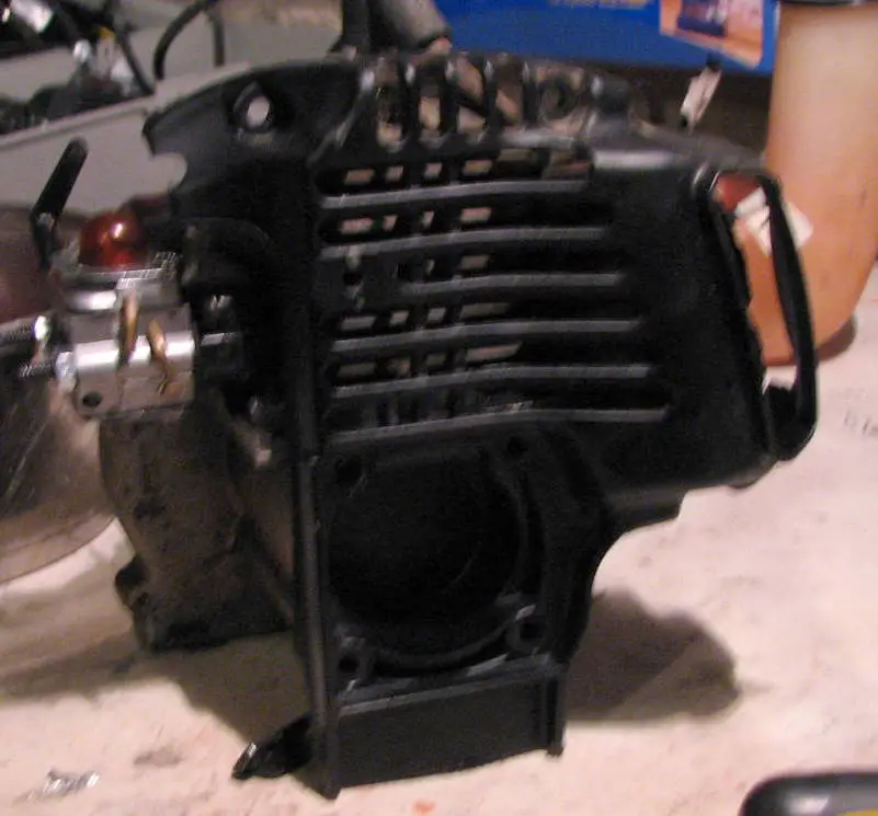

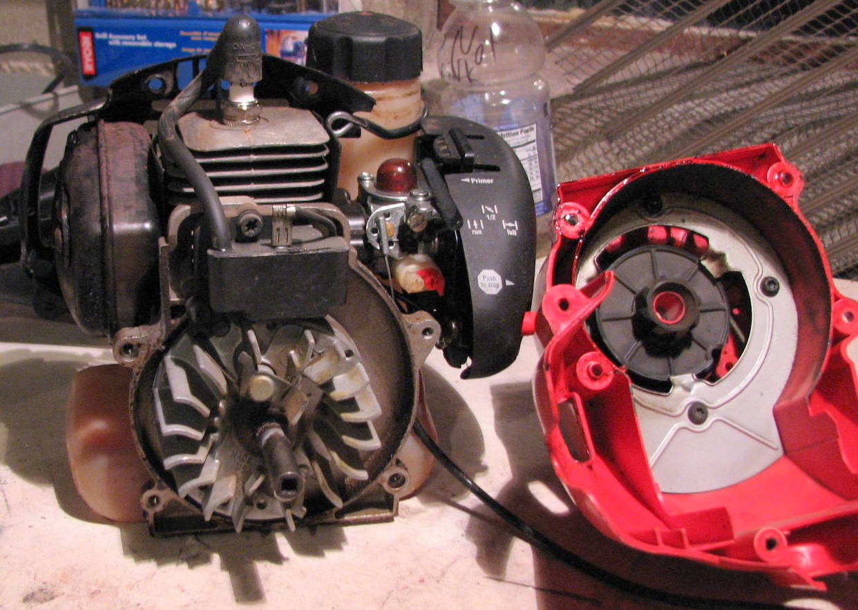

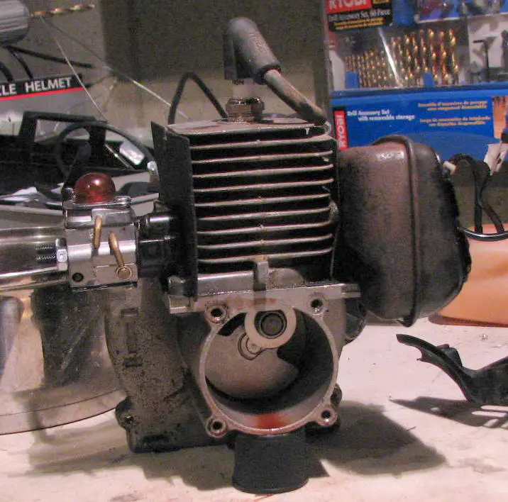

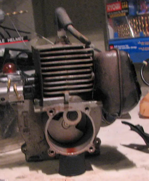

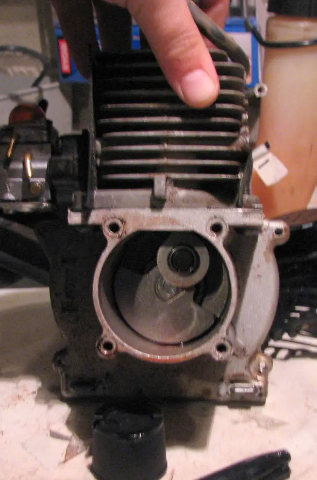

here's something I didn't expect that black plastic that I got the really crappy picture of? that covers the crank! Pull that off and there is the inside of the engine?!? This could also be a source of woe, the seal on the gasket seems iffy, lots of oil all around it. Lots of red greasy gas too. it feels like oil though.

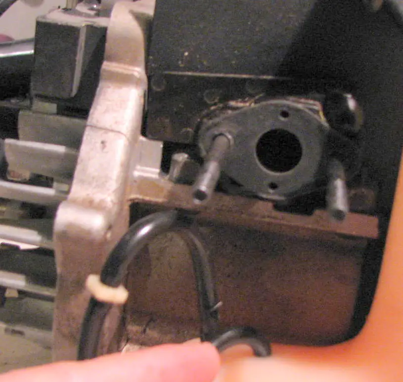

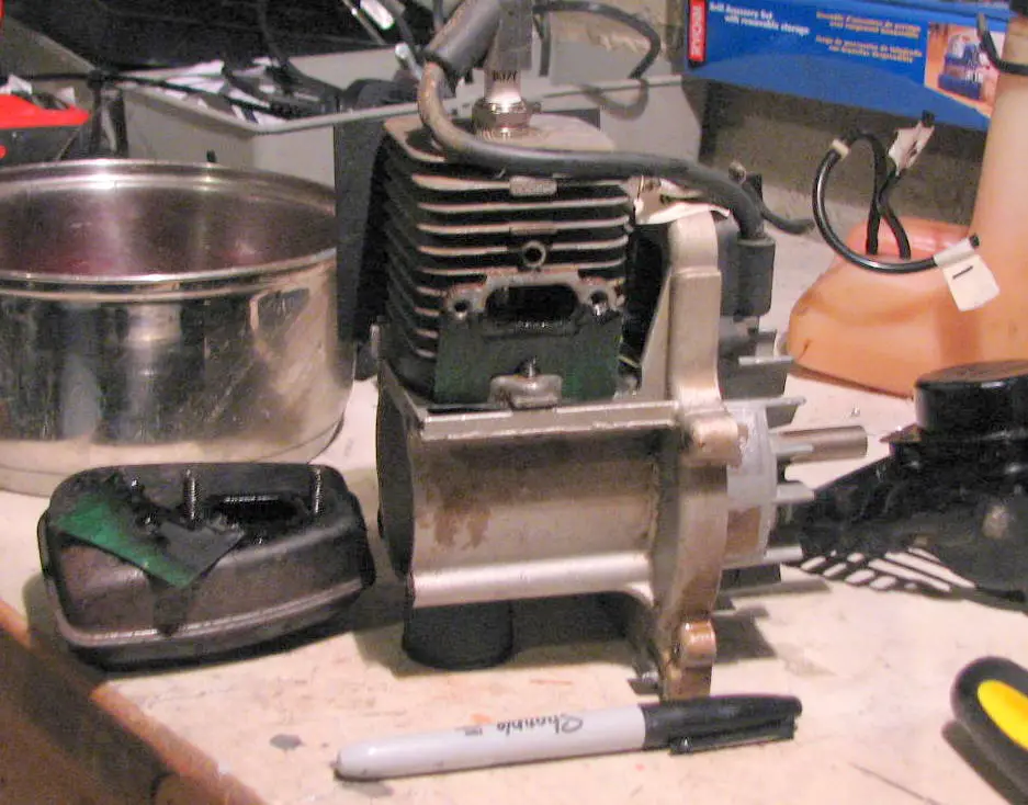

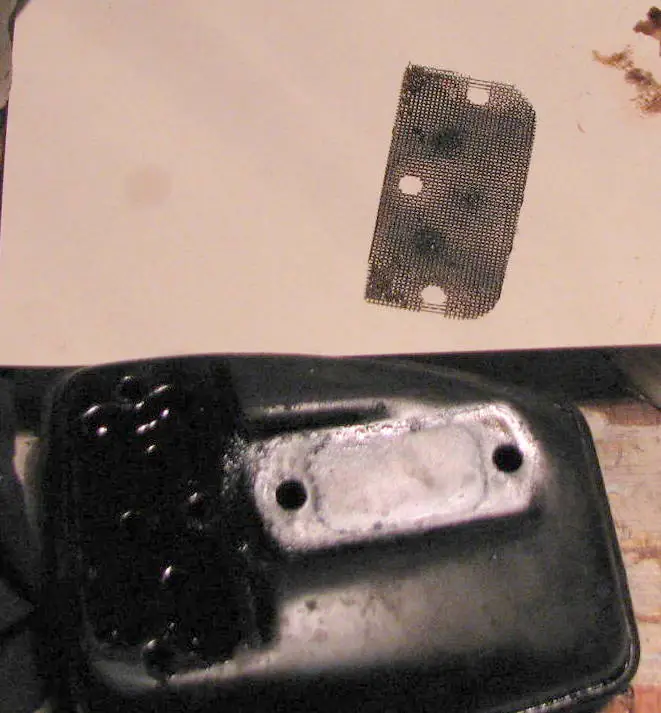

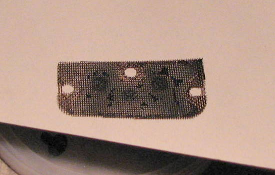

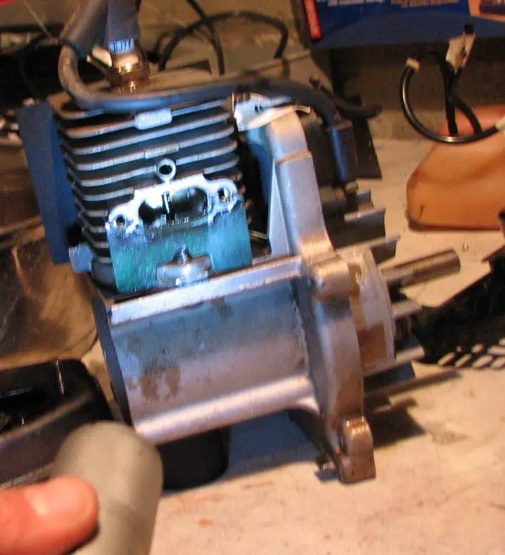

Got the muffler off, seems overly heavy for it's size, look around the openings... not much to see. No build up on the exhaust port, the muffler looks okay, take off a plate and there is a screen covers 3 little holes there is a little build up over the hole, i half @$$ clean it off. Looks a lot better, not so visible in the picture.
During the test firing of the muffler I found this to be a very quiet engine. more so than either of hte other 2 I have.
Ripping it down I'm shocked at how small it is.I don't know, The website says 25 or 30cc but I'm not convinced. I understand now though, why people like homelites for RC use, if this is the case with all of them- small.
The exhaust port is the same size and shape as on the scooter I have. That opens up possibilities for using scooter pipes.

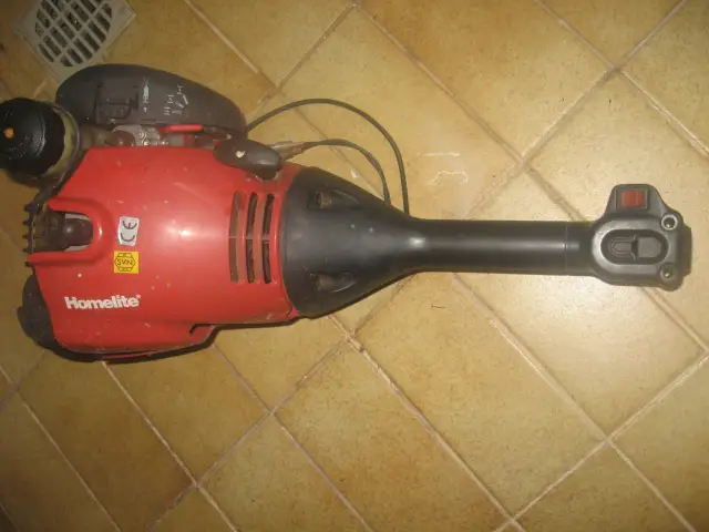

Old 08-21-2009, 10:53 AM
urki urki is offline
Join Date: Jul 2009
Location: slovenia
Posts: 1
Default Re: homelite tear down and cleaning
Originally Posted by comfortableshoes View Post
Some pics:

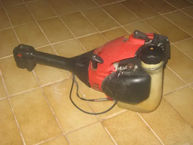

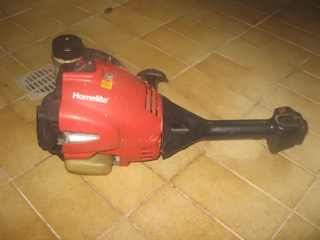

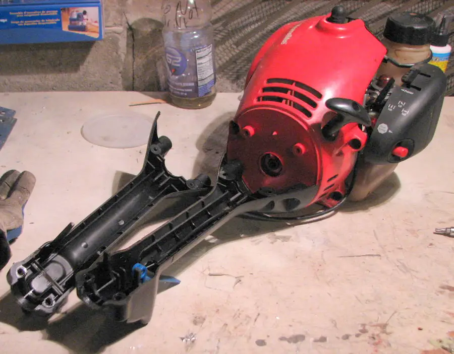

Can you tell me a model of that tear on picture (I broke the gas throttle and don't know the model to order part)
