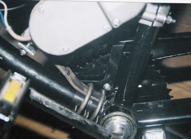

here's how i took of this issue

Old 01-20-2008, 11:02 AM
wayde wayde is offline
Location: Niagara falls canada
Posts: 23
Default Re: OVERSIZED TUBING solved
it actually is a 2 1/4 muffler clamp

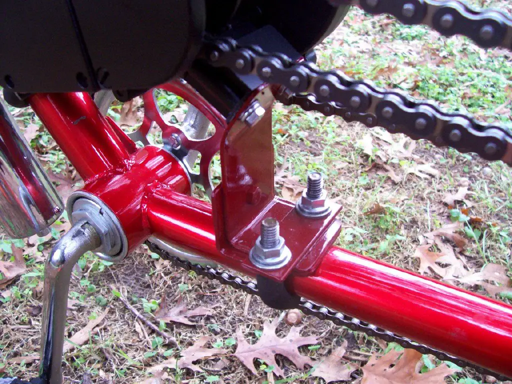

I used U-Bolts on my install and they work well. I also used automotive fuel line, which comes in various diamiters, to kind of shroud the bolt

Old 02-01-2008, 12:44 PM
deacon's Avatar
deacon deacon is offline
minor bike philosopher
Location: north carolina
Posts: 7,867
they make a heater hose in up to at least 1" diameter I think. I used it to wrap my undersized tube. Hard to believe there is actually a tube too small for this toy.
