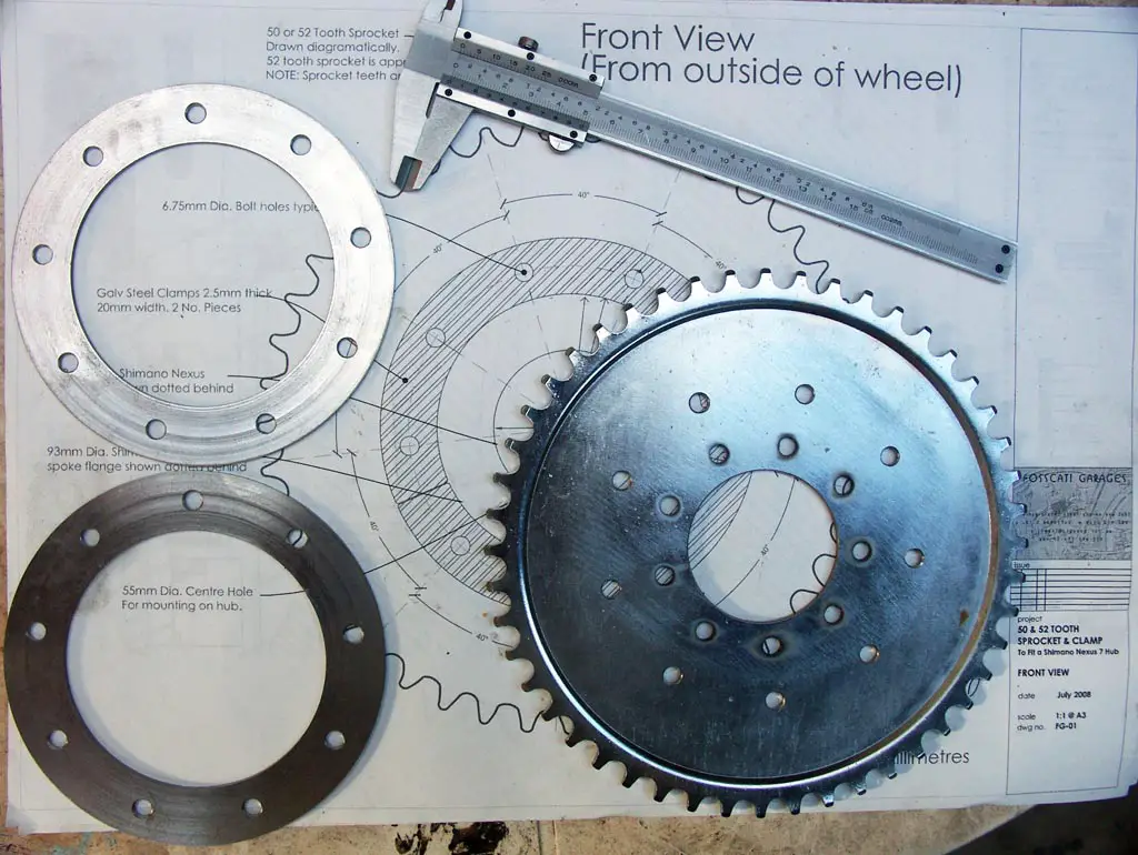

This is about my latest build - a Schwinn Deluxe 7 Cruiser with a Honda / Grubee rig. There were a klot of problems to overcome not least the Shimano Nexus 7 speed internal hub that came with the bike. I had to make my own sprocket and clamps for it. Having designed and made the clamps & holes for the sprocket I wonder if anyone else ever needs to motorise this bike I could supply them with the clamps etc. cos although the first one cost me $180 to make I could get them made for much much less if I was having a batch of 10 done.
Anyway you can let me know if you are interested and I'll see what I can do.

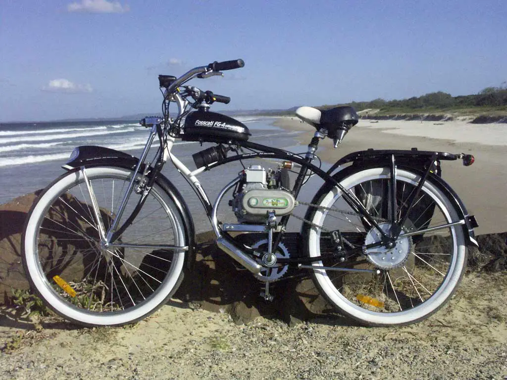

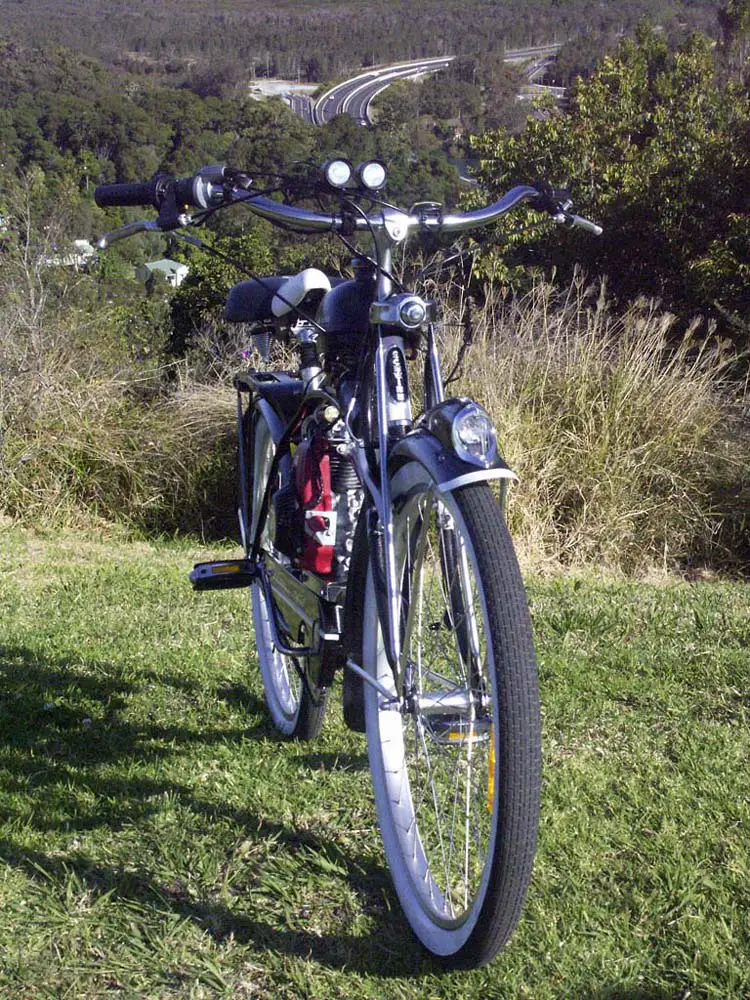

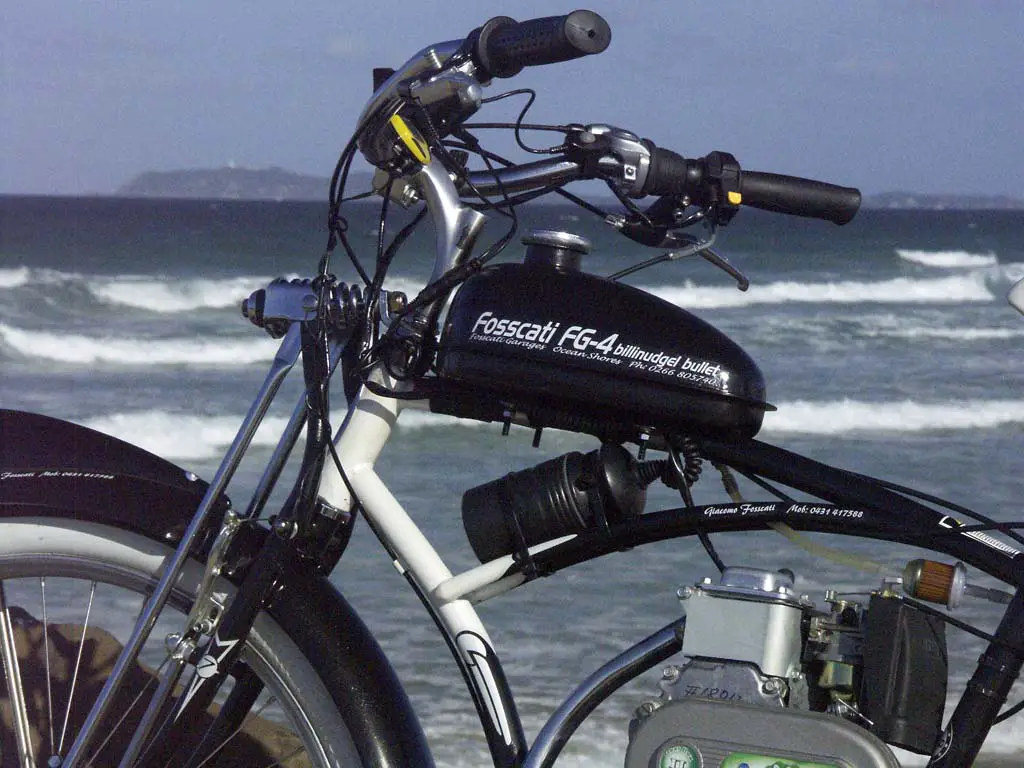

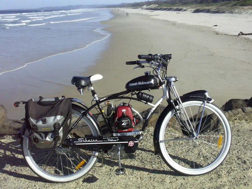

Anyway here are some pics of the finished product and the custom built hub. I love the 7 speed internal hub gears cos the chain never comes off like on a derailleur. Pity about the coaster brake though.
