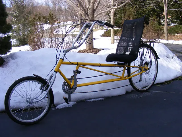

Have fun. Is your lady going to paint a picture of the soothing view of your driveway? Just a thought, love that picture.

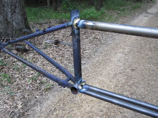

I have the frame fitted together and tacked. It is made from two Trek mountain bikes with chromoly frames and some chromo tubing that I have been saving. The whole frame is from chromoly tubing and is light. One of the bikes was a 13" frame so I was able to use the rear triangle intact. It will be very similar to this yellow bike but built with room for the HF 2.5 engine.
