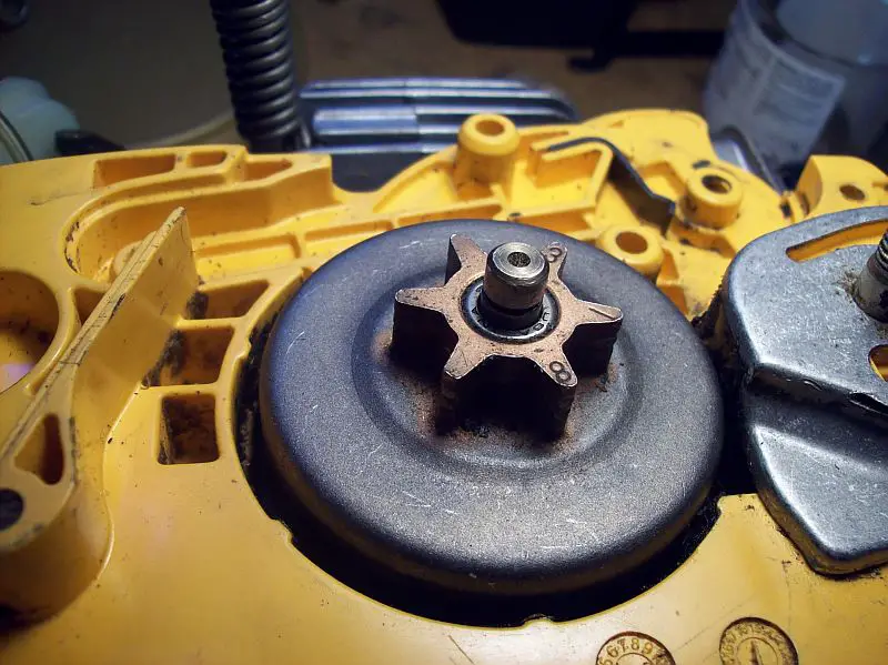

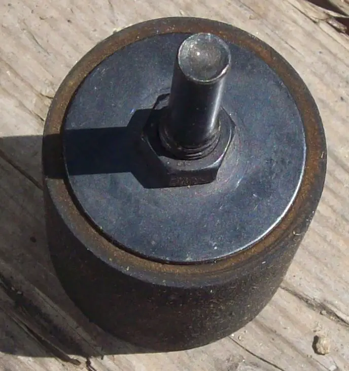

I am so thoroughly disgusted with those chinese chains and sprockets that I can't stand the thought of another build with them. Here's my idea. A 42cc chain saw engine. I've gotten lots of mounting ideas. My question right now is how to attach a drive roller onto the drive shaft of the engine. Centrifugal clutch and pull starter looks real appealing. That drum sanding drill attachment I thought would make a great friction roller, but how to attach it?

I cant help you I took my clutch off my chainsaw. I attached my drive directly to the drive shaft of the engine. I use a gravity clutch which is no more than raising and lowering the engine.
I agree about the china bike by the way it's why I got interested in the diy friction drives.
How about welding a sleeve over the drum sander's shaft then welding the sleeve to the clutch drive gear.
So you're saying an alternative would be to remove the centrifugal clutch and attach the roller directly to the engine's drive shaft? Then, by using a lever and cable you could lower the engine onto the tire after you got pedaling along. I think I've seen that done somewhere. Question: wouldn't that leave just the weight of engine pressing down to make contact with the tire and would that be enough to prevent slippage? What I've seen is using a quick disconnect and slotted supports to raise or lower the engine. That way you can force the engine down onto the tire with some pressure, then lock it in place.
