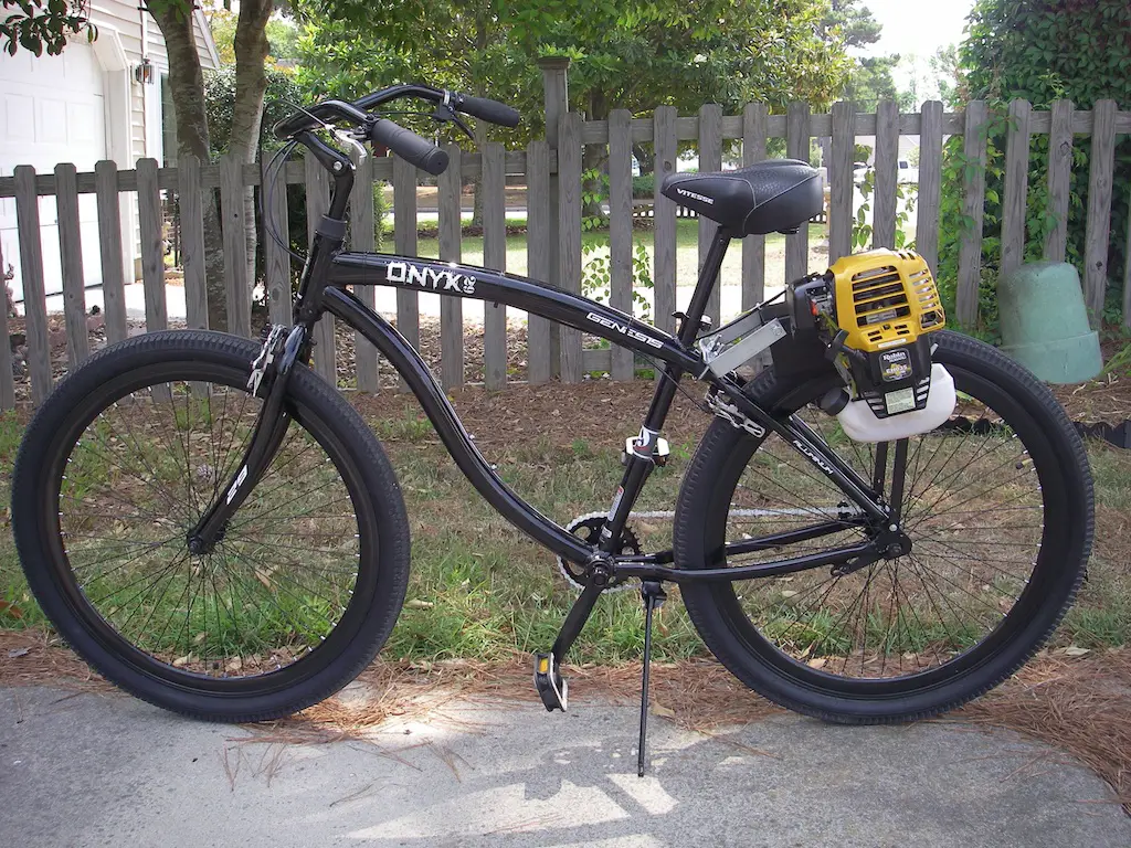

Thought I'd post a "final" picture of the bike. Only things I've changed were that I removed the chain guard because it was so wimpy and rattled badly, and I cleaned up the wiring for the kill switch. I also got the FD nice and level after a bit more tweaking. I'm happy with her now so I've decided to sell her and build another! The next bike will be a multi-speed mountain bike with an electrical drive.
