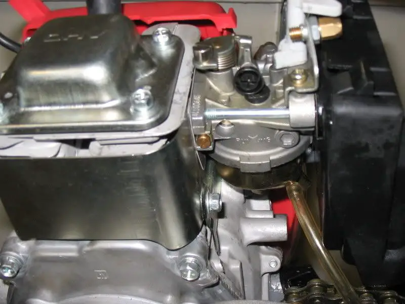

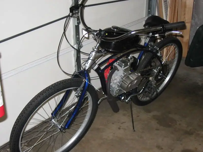

Well, it's about 80% complete. I need to install the throttle and muffler brace and then it's time for a test run. I'm new to building these marvel of cheap Chinese labor and have a few questions for you guys. I notice when I test fired it tonight that it seemed like the clutch was engaging at almost an idle. I'm not sure if that's due to the clutch being new or a result of poor workmanship? Secondly, the engine (4 cycle) really doesn't want to idle. If I flip the choke to half way, it idles better. THat cold be a result of the clutch attempting to engage too early or a mixture issues. I know that symptom usually indicates that the mixture is probably too lean, but I'm not sure if there's provisions on the carb to richen the mixture. On one of my photos, there's what appears to be a brass mixture screw near the front of the carb. I guess I'll have to play with it and see what it does. Also, it's doing the gearbox vent hole weep, and that I'll fix this weekend as well. I also had to cut and weld the muffler pipe so that it wold clear the frame and pedals. Finally, I place inner tube between the engine mounts and the rear chain idler. I thought I read somewhere on here that doing that is a bad idea. I can see how these kits require upgrades and tweaking till they're dependable, but I must admit that I can't wait till I can ride it tomorrow!!

The engine is a 49cc Huashengtai Shan, which is a 4 cycle Honda clone. I bought the kit for $269.00 including shipping. The gentleman I bought it from, Bill, is a blessing to work with. I had one small issue with the choke lever and he sent a replacement out pronto. He responds to his emails and is a man of his word. His website is Welcome to bikekitsdirect.com
The last I spoke to him, he was nearly sold out of the kits.
I ran the engine last night and it is very quiet. At 51, I enjoy quiet and stealth over loud and flamboyant.
I should be ready to ride by either late tonight or definitely tomorrow.

Just a thought...once you have the throttle on, and the bike is warmed up, it may run better without any choke. Small four strokes seem to take awhile to warm up.
Also, the clutch may do better after some break-in.

I took the bike out for an initial 1/2 mile shake down cruise and the idle and clutch seemed to settle in a bit more. I think your advice is dead on, it needs a few miles under the wheels to loosen up. What a blast it is to ride. It got dark too quickly and I was limited on my ride time. I have a few odds and ends to do, but it's basically there.
Next up is better tires and twin saddle bags. I also would like to mount a springer front on it, but I need one that I can add brakes to it.
