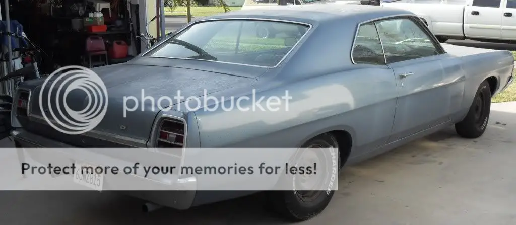

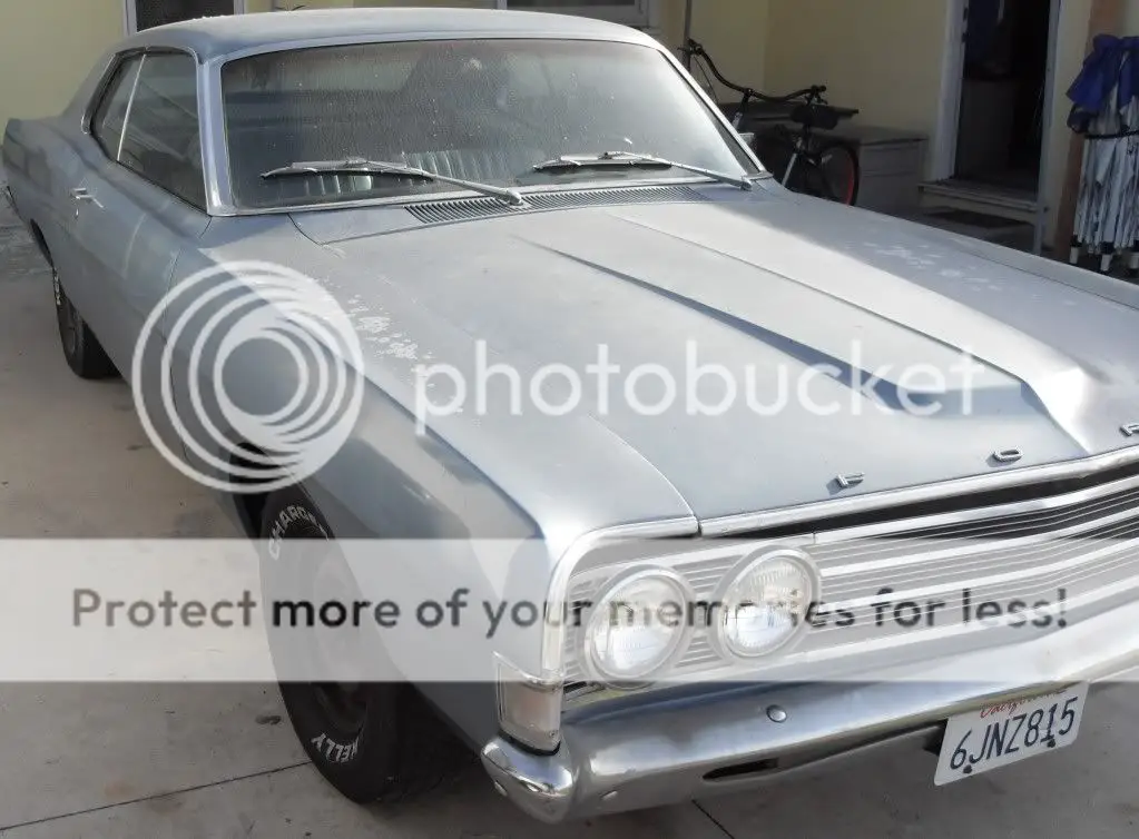

It was a pretty clean car. Some damage to the driver side door and rear panel. It's a '69 Fairlane 500, 302 C4 in real good running condition. I have a friend who runs an impound lot and he sold it to me cheap. I bought it to chase parts in while my grandson and I got his IHC Scout going. The kid works the Pamona swap meet and when we were done with the car, some Ausies bought it and shipped it down under. Wish I still had it, it was a bomb to drive around town, but didn't have a use for another vehicle and I doubled my money.
