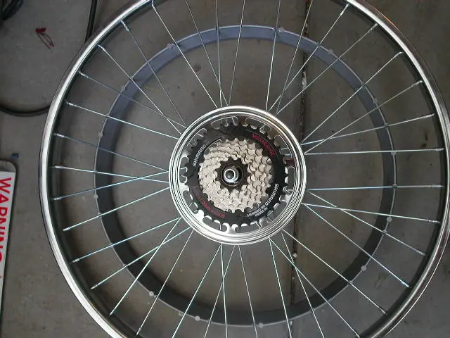

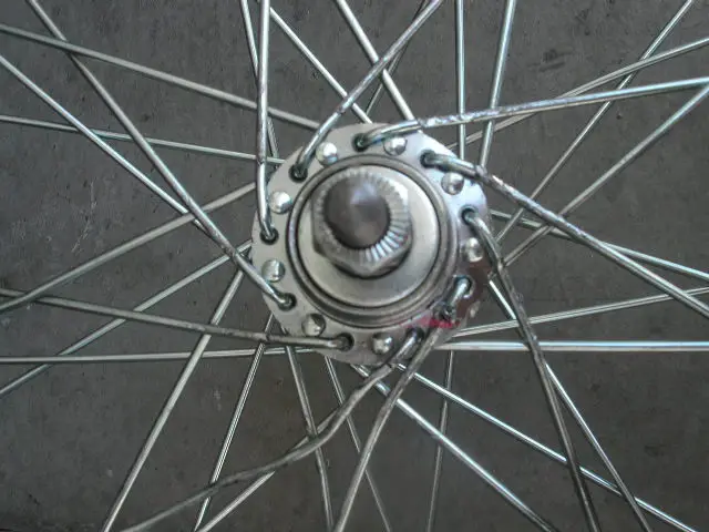

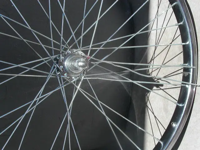

i thought i would share what happened my wheel after the chain fell of the back of my cassette and lodged between the spokes.
This is a heavy duty 26inch steel wheel from wheelmaster with 105 guage spokes. two spokes were ripped out of the rim, and the others got beaten up.

Hopefully the $4 spoke guard should save the wheel in the future...

BE WARNED

hi datz, no the rim was useless after this accident the force of the chain pulled the spoke heads straight threw the rim rendering it useless so i had to buy a new wheel.
The wheels run under $50 ordered from my local bike store, they are made of steel and the finishing leaves a little to be admired, they have to be lined crazy because of the size of the spoke nuts, that been said they are a very solid wheel and i feel alot safer with them than the orginal stock wheel.
costly lesson but we live and learn.
