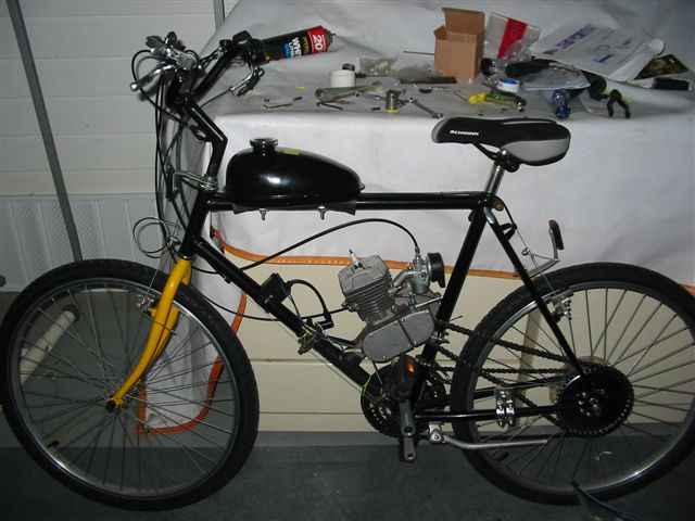

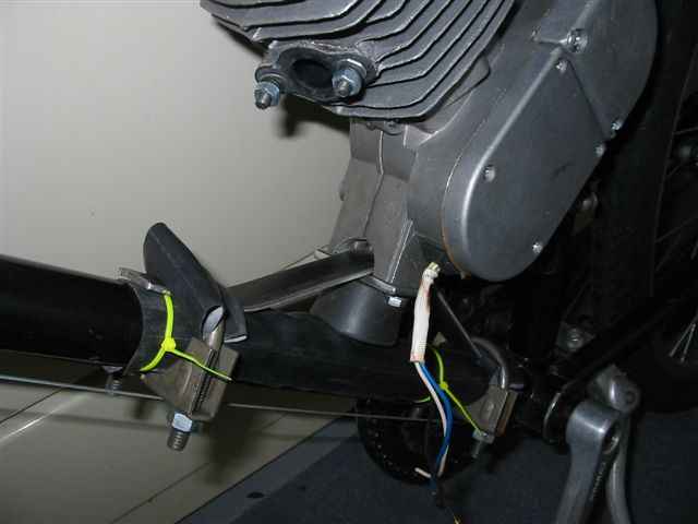

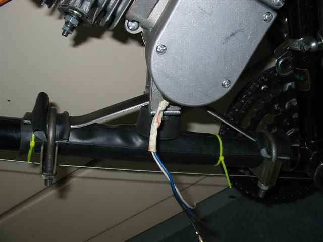

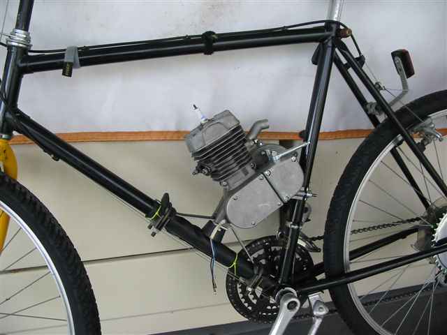

Well, I got my Boygofast kit yesterday and proceeded to install it. I will admit there is a "learning curve" to installing one of these motors. My bike has a 1 1/2" lower tube which presented a problem for me, I used many tips that I read on this forum, such as using a chain in the gas tank to clean it, the front mount I made is similar to one I saw on here, and may eventually change it to one more efficient. Tomorrow I will attempt to fire it up, and I'll pick up the pieces that fall off
It was fun assembling it, but at times a little frustrating too. I figure the next one will be quicker and easier, I have a few bolts and nuts with washers that I have no idea where they are supposed to go. As expected the instruction manual us useless, But I have no problem figuring out where things are supposed to go (except for those bolts and nuts). LOL...
I will post a follow up after I start it and will no doubt have questions for "help me".....

IT RUNS!!!... Kinda rough though, i mixed a little 20-1 mix. I guess I didn't clean the tank very well lots of black soot running through some water too ( i rinsed with soapy water) I purge it when I see it. All in all it's a fun thing, I will "fine tune" the components as I use it. One thing I haven't found a place for is a skinny spring about 1/8" in diameter 4" long, it came in a pkg with the clutch cable spring, can anyone clue me in as to what that's for?. Also my muffler is just slightly in the way of my pedal crank (rubs) I need to bend it to the right, (what's the best way to do this?)... Thanks, Bob...

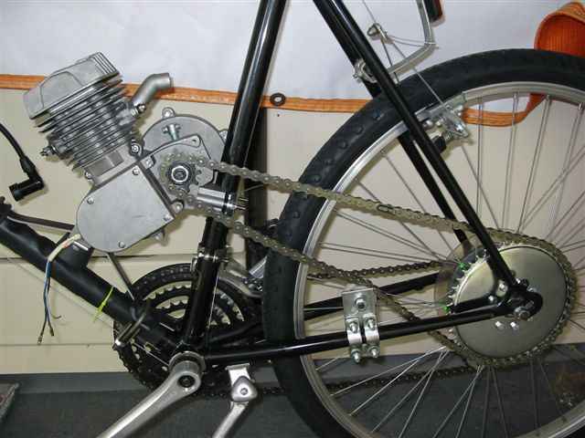

thanks for the info jasonh, I hope this hobby isin't going to be a "fix it all the time" kinda hobby. This evening I took my bike out for a short ride and the "fargin master link" gave way and the chain wrapped around the rear sprocket and put some gouges in the outside surface of the disc. I remember reading somewhere that someone doesn't use a masterlink, but instead just puts the chain together with a solid link. I didn't think the master link with the kit felt all that secure, I guess I should have listened to my "gut"... anyway fix it tomorrow, any recommendations on chains and links would be welcome and appreciated.

I use a #41 chain from Tractor Supply Company. any place that sells these kinds of chains will probably have the 41. I also do not use a master link. The pins in the links are a press fit, if you don't press it all the way out you can press it back in. I've found this to work a lot better for me.

I was at the TRactor supply store and was going to buy a #41 chain but i compared to a few links of my original chain and it was noticably smaller, I think the kit chain must be a heavier duty, anyone have any input on this?...

I have yet to have a problem with the stock chain other than some loosening while breaking in.
#41 looks different, but fits our sprockets fine. Stronger too.
