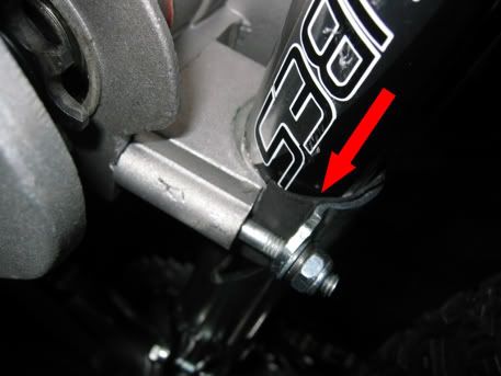

Today I started my first build and I was looking at the grip shift grips and was thinking ?????
Why not reuse this as motor mounts for my engine? So I was able to on the front mount and the rear I had some pieces of rubber that worked better. I sliced them long and then cut out the middle.
Pictures have been provided for illustation..............
DSC02967 on Flickr - Photo Sharing!
DSC02963 on Flickr - Photo Sharing!

I fiqured it out...........Enjoy?

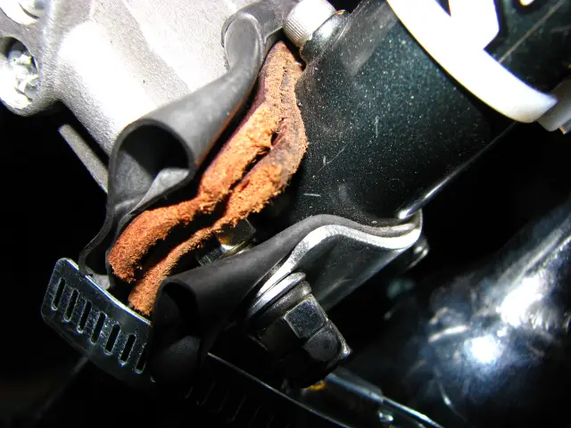

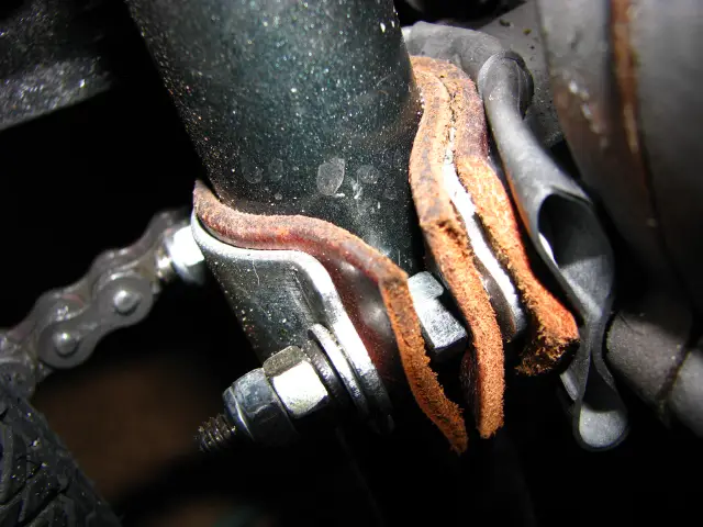

sounds great. everybody comes up with the solution to fit their frame and it's geometry.
I like using old leather belt, innertubes and the clamps that come with the kit on both the inside and outside of the tubing:
front
rear
jon
