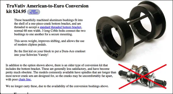

You can get a conversion kit to convert the american style bottom bracket to accept a 3-piece crank. A good bicycle shop should be able to fix you up with one or you could search online. Electra also makes some cruiser style bikes that have 3 piece cranks but they sell for considerably more money than a walmart/k-mart bike.

Now you can choose the bike that you want.
Parts for older American Bicycles
That thing that was crossed out would work too though.
Look here:
http://motorbicycling.com/f6/changin...html#post24887

The 4 stokes are a wider engine than the 2 strokes, so the wider crank is necessary. They engine kit contains a three piece "crank set" (two crank arms, and chain sprocket) which requires the "square shaft bottom bracket" to mount the crank set on. Most (practically all) of the bikes I looked at have the one piece cranks on them and that renders the three piece crank set that came with the kit useless. I know my terminology is not the best, and I'm probably not explaining myself in the most accurate way as well.
At any rate, I need the square shaft type bike to bolt my crank set onto.
The Ashtabula type one piece crank will not work for my 4 stroke engine.
