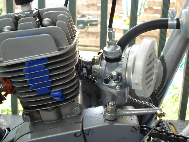

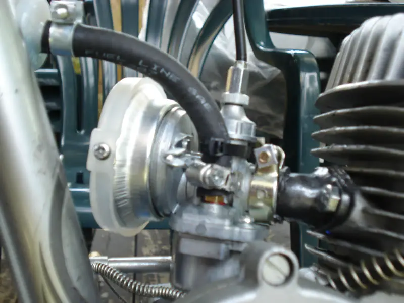

MarcPhotoMan MarcPhotoMan is offline
Location: Montreal, Canada
Posts: 258
Default Re: Will it hurt to increase air flow?
I have a filter that lets in more air I lowered the clip to make the mixter richer I checked ny plug so far it looks good.
My bottom end and top end are better, but I also have a shorter intake.

Old 08-08-2008, 07:10 AM
saetta's Avatar
saetta saetta is offline
Join Date: Jul 2008
Location: Central Missouri
Posts: 155
Thanks. Exactly what clip are you talking about?
Old 08-08-2008, 07:14 AM
Bikeguy Joe's Avatar
Posts: 10,864
There is a clip on the needle in the carb...moving it up makes the engine leaner, moving down obviously make it richer. It's the only adjustment on the carb other than the idle speed.
More air need more fuel, Less needs less.
Old 08-08-2008, 08:48 AM
jasonh's Avatar
jasonh jasonh is offline
Join Date: Jun 2008
Location: Longmont, CO
Posts: 1,596
If a 2-stroke is anything like a car motor, I'm not surprised your top end is better. But I figured the bottom end would suffer a bit. Shorter intake = more high rpm hp but less low rpm tq. Longer intake = more low rpm tq, but less high rpm hp. For cars anyway. These darn 2-strokes are still new to me. I guess maybe the air filter alone helped your bottom end, and the shorter intake runner helped the top end.
