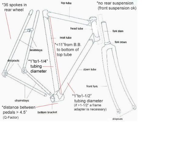

There is a graphic somewhere 'round here that has the required measurements of a bike frame to fit the HT motor. Hopefully fairracing will chime in, he usually has that graphic readily available. Of course since it's a chopper, it's probably configured a bit differently, so those measurements might not apply.
If you could get a pic of the kids stingray and get some measurements, it might help.
Old 08-08-2008, 04:21 PM
Dave31's Avatar
Dave31 Dave31 is offline
Location: Tucson, AZ
Posts: 8,978
Default Re: 49cc on a 16" stingray?
Well here it is Jason but I don't think it applies to the chopper.

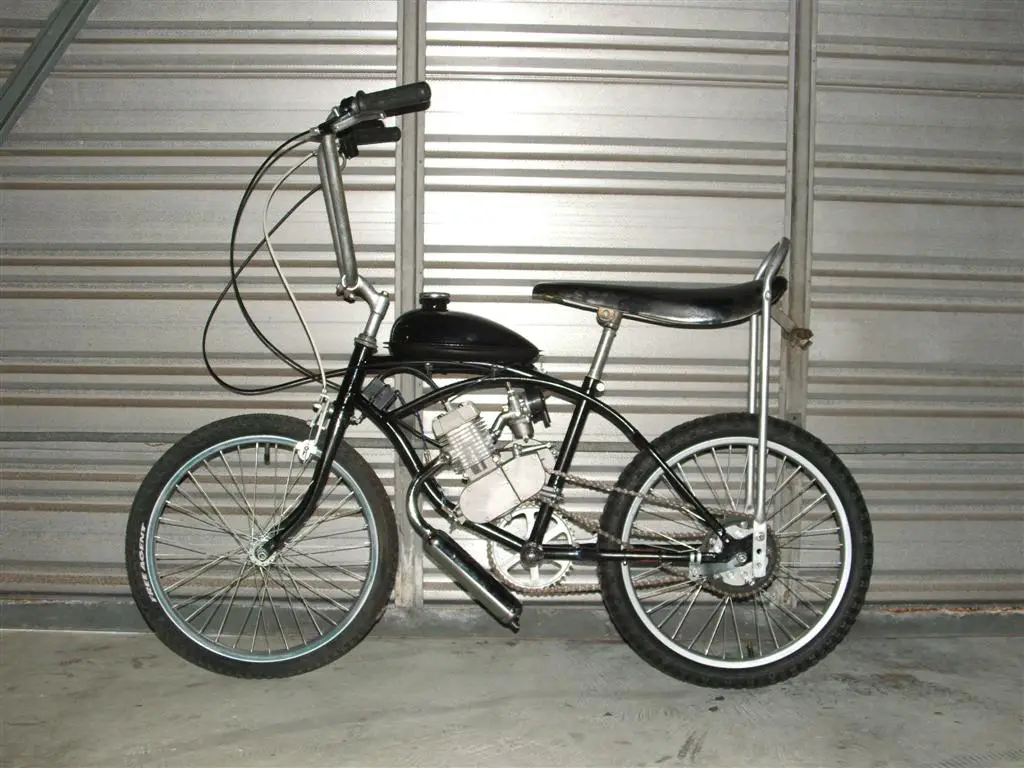

Like this one I made?
i was just looking at the picture and see that i will have to stretch the frame another like 4 inches to just fit the motor in with n extra space
Yea that one is just to dang small I think. I wish they would have never started calling those stingrays. Wish they would use choppers instead. But sorry Pi I thought that you were talking about the other kit that Wild posted a pic of.
