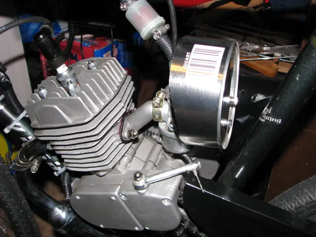

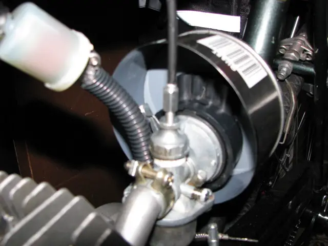

well, I got bored ( I hate that). walked around Home Depot until I saw an empty quart can and thought:
so: or
just trying to get a little more airflow, without doing a boost bottle.
jon

Cleaning up the intake will not likely need a clip adjustment unless accompanied by an mod to the air filter cover.
You may see slightly higher revs, or a little better pull in the mid to upper end of the rpm range.
