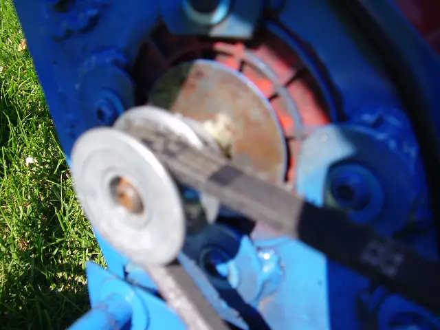

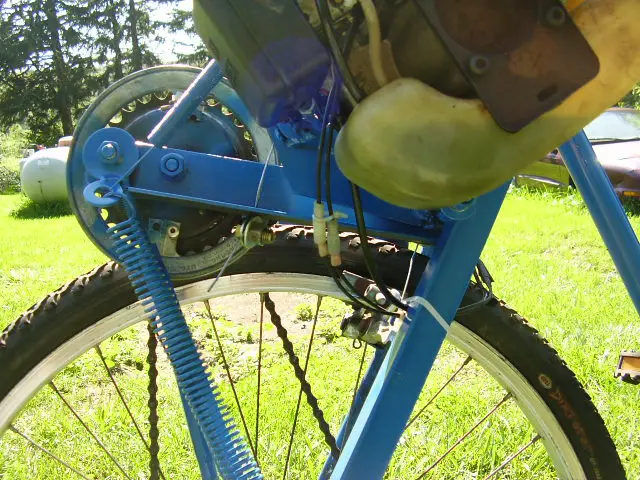

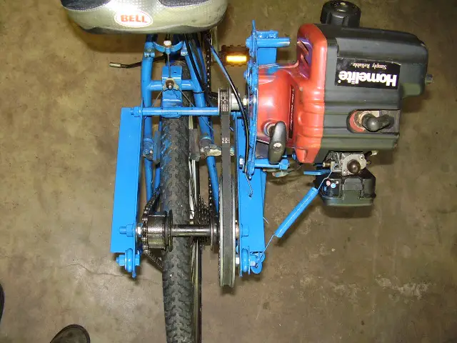

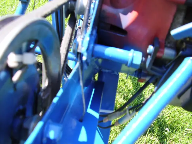

I recently built two weedwacker bikes. I mounted one engine to a flat piece of 1/8" steel using the four holes around the crank. Had to do some pretty accurate hole drilling and a lot of filing to get it to fit tightly but being mounted tightly to the plastic keeps the vibration from cracking the cast aluminum and the plastic will give before the casting does. This mount plate has a hole in it under the engine used to pivot it for belt slack when I need to clutch. Also a spring to hold the belt tight.
Check out my pics.
The belt drives a pulley welded to the free end of a 10 speed bike hub and the other end ratchets for a freewheel. When engine is running and clutch is out, it drives a bigger gear on the left side of the rear wheel. This gives me the ability to pedal with engine off and clutch out. No belt friction as the 10 speed hub ratchets freely, just the chain goes around but hardly any friction there. A free wheeling gear on the rear wheel would have been better but I didn't know about them until after I built this. I also used turnbuckles to refine the chain tension to eliminate a tensioner there. So far I have logged over 200 trouble free miles and I estimate the top speed on a flat at about 34 or 35 mph. Can't wait to get a speedometer on it to see, but it goes way faster than I can pedal even downhill.
Hope this is helpful, Scott
