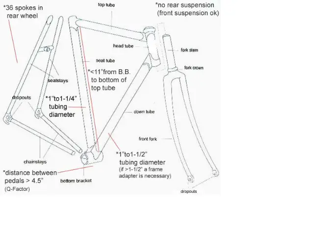

Originally Posted by Weedylot View Post
This subject is probably already here somewhere, but anyway I have two very large framed Schwinn Varsity bikes gathering dust, I have searched some for this topic but my feeble computer skills are lacking. Has anyone done mods and motorized an old (70s) Varsity?
Does the bike you have meet these requirements?

Cool Re: Need Tips And Help , Look
Yep, 27" Schwinn 10 speed. I put a kit on one, rode it once and removed the motor. For ME the rims an tires are way to narrow! Felt like pushing cooked pasta on glass. Speed A+ don't know just how fast it would run. The road racer does NOT like corners. If you have the stuff, and time give it a try. On a flat straight road, with the right gears, I would bet you could see 90 mph.
