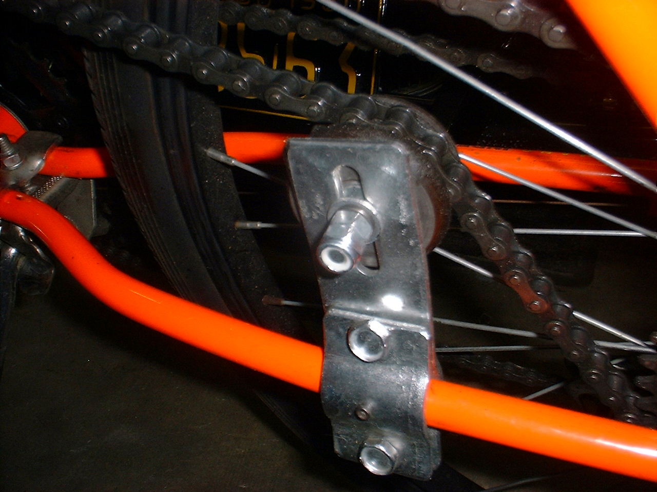

I agree with Joe. It's more probable that your tensioner loosened, a notorious problem unless you secure it to the frame, and got into your spokes.
To avoid this get your tensioner alignment perfect, even if it requires a little twist in the bracket to get the wheel aligned with the sprockets, then drill a 3/16" hole through the tensioner bracket and the chainstay. Install a #10, grade 8 screw through the hole and a lock nut with Loctite on the inside (wheel side). Be sure to position the tensioner so you'll have room to move the wheel up or down to adjust chain tension.

A picture is worth a thousand....
Take a look at this.
