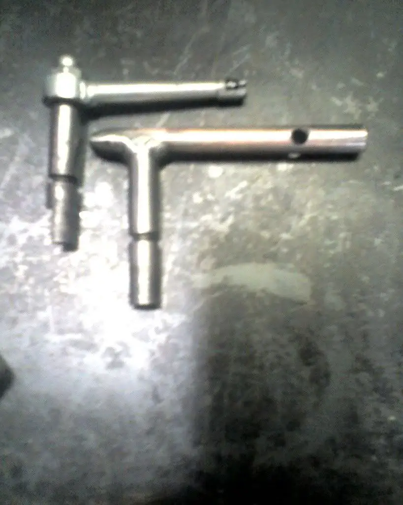

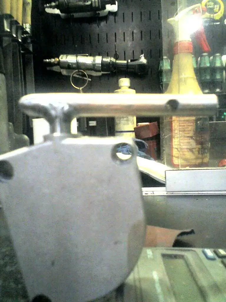

Most have probably read my post about the new and improved clutch arm and cam I made. Complete failure, lasted all of about 10 minutes. It wore the cam the same way, instead of being a D shape, it rounded off the flat edge that actuates the clutch rod.
Looking at it I could see swirl marks in the rounded off area, the clutch rod had the same swirls. I pulled the rod out and there is no ball bearing in there, this could explain it if I'm seeing things right.
The arm turns the cam, the cam presses the actuating rod which in turn pushes the pressure plate away from the clutch disc thus disengaging the clutch. Correct? Seems as simple anyway.
My question is of the ball bearing in there. Is the ball bearings' only purpose to interrupt the spinning motion of the clutch to the clutch rod? If not I have a problem on my hands I cannot see past. I never thought about the ball bearing and figured it was weak material instead, but now think the clutch rod is constantly spinning and wearing the pressure point down. Today is the only time I have removed the clutch rod, I'm positive there is nothing in there but a flat surface.

Something is wrong with my clutch. Thinking it has something to do with the ball bearing but not sure. The clutch works for a short time but wears the clutch cam fast. I took out the rod and cannot see a bearing in there, just a flat spot. Searched here and elsewhere and found others with the problem but no real solution. One person even had their ball bearing wear flat, not sure if this is my problem or not. Getting a new bearing today but have to wait until 9.

After going around the block a few times on my first ride I noticed the clutch was not fully disengaging. It progressively got worse. I thought the cable had slipped on the clutch arm. While adjusting it I noticed the screws to the arm cover were loose and the cover would seperate from the casing when pulling the clutch. Tightened those up and adjusted the cable, everything worked fine. But..... The clutch arm, when disengaging, was pulled all the way to the carburetor. I got the lever off and turned it a few splines to get clearance and all seemed to be ok for awhile. I took the cover off and noticed the clutch cam was worn and thought it was due to cheap material so I tried making one out of steel, worked fine when not running but it did the same thing to the steel one after going about 3 blocks.
I pulled the link shaft(as you called it) and noticed there was not a round bearing behind it, just looks flat. Been searching both bike sites and have found a couple different threads that are like my situation but none said what the issue actually was or the fix. From what I have read, the clutch should not work at all if the ball is not in there? I have a new clutch cam and lever ready to go but don't want to try it until I hopefully figure out what is going on.
