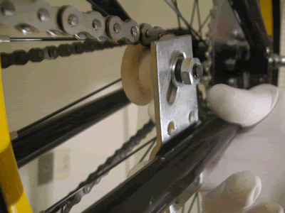

Got to keep the chain from knocking the frame before I choose where to set the tensioner. 1 step @ a time. Secondly. I am still attempting to find a good pic of how that is set up.
