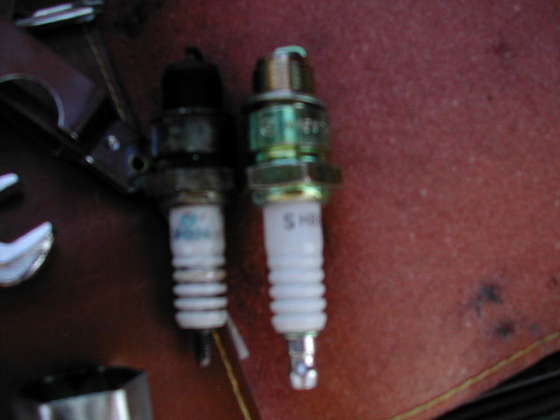

This is how the plugs look like, left is stock, right is NGK B6HS. The right one has the silver over the threads on the bottom, and i want to remove that but i dont know how, and i dont wana mess anything up, help please

yep, that is exactly what mine looked like...the stock plug doesn't have the silvery connecteor like the NGK plug. the stock plug has been modified. it's crap anyway...i bought a racing plug cap for $5 at my local cycle shop, and it fit the NGK.
you could try to unscrew the silver part of the NGK with pliers.

I thought the top of the NGK was supposed to be able to unscrew easily? I'd probably just get a new cap and wire at the auto parts store.

Just unscrew the top of the NGK.
Replace the plug cap and wire when you can. Buy a 7mm. Unscrew the old one from the CDI and screw the new one in.
Keep the wire as short as is practical.

Im not sure if it will unscrew easily because i cant really grip it right and i dont wana put to much force and break it=[

Just grab the silver part with some pliers and squeeze it hard and unscrew it. I just did it to one to check it....it's removable

Ok well the pliers helped me unscrew it, i just didnt put to much force into it for it to move, cause i went throw a lot to get the NGK and i didnt wana break it, im trying to find a plug and cap but i cant find any 7mm, and not sure if they will fit right into the cdi and i the only wire i found was the accel but it came with 6 of them for $40=[
