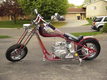

Ive painted all of my mini chopper projects. Believe it or not here's what I do...
__Ace hardware, Smallest pint can of Gloss Rustoleum mixed to order. (they have a color chart for colors) 1/3 part Gloss Rustoleum to 2/3 parts of acetone. Yup, the acetone is 4 times more plosive than the gas and it evaporates 10 times faster. Gas dosent effect the paint because the paint isnt as potent as the acetone. The acetone seems to harden the paint, or chemically changes its base? 6 thin coats and the finish has plenty of gloss. Dries to the touch in 10 minutes. 3 coats of wax after 5 days.
__I havent dumped gas on it for hrs, but ive wipped it off after 3-4 minutes with no problems.
Im sure automotive paint may be better, but I dont want to pay $45.00 for a quart of paint. $40.00 for thinner and resins/hardners. Im just cheap! $12.00 and I paint the whole mini chopper. I only use about 8 tbl spoons of paint for the entire chopper. Good luck on whatever you do. graucho P.S. This principal dosen't apply with canned Rustoleum. The secret is in the acetone.

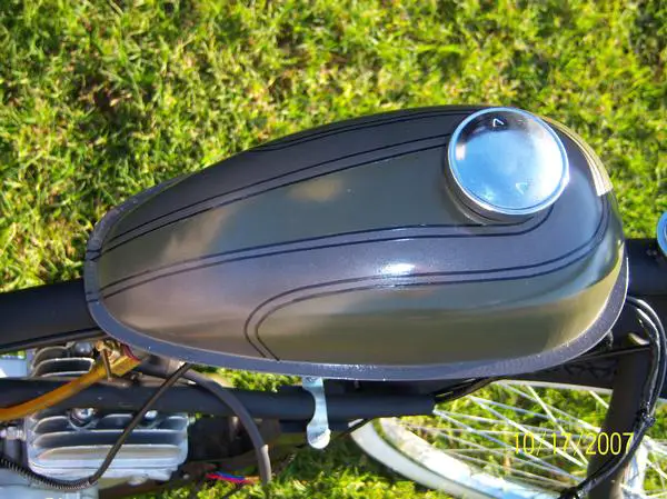

some paint that I've discovered, way back when I had a similar problem you're having, is engine paint with ceramic. You can find it in any auto parts store and you don't really need to use primer or clear. It comes in a wide variety of colors. Many of them come in either low or high gloss finish. My current bicycle sports this paint. The frame is low gloss black and the tank is a mix of OD green and Cast Iron. I used clear and auto adhesive pin stripe on the tank.
