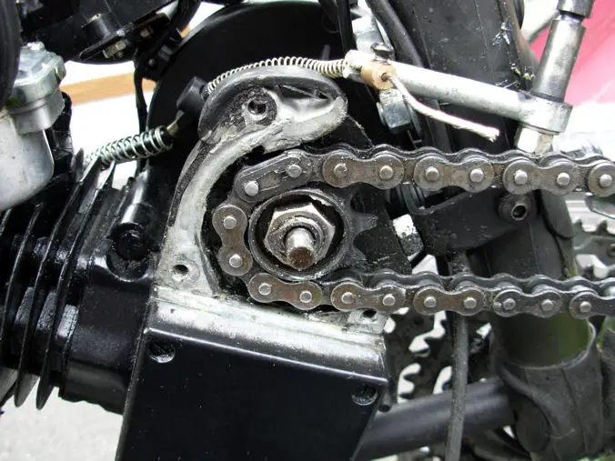

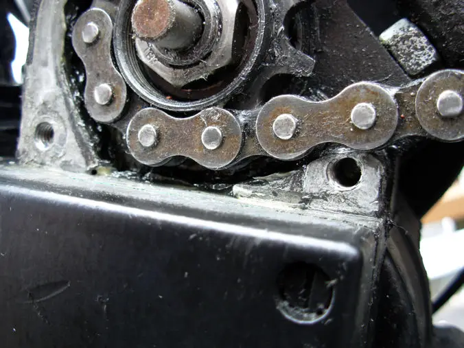

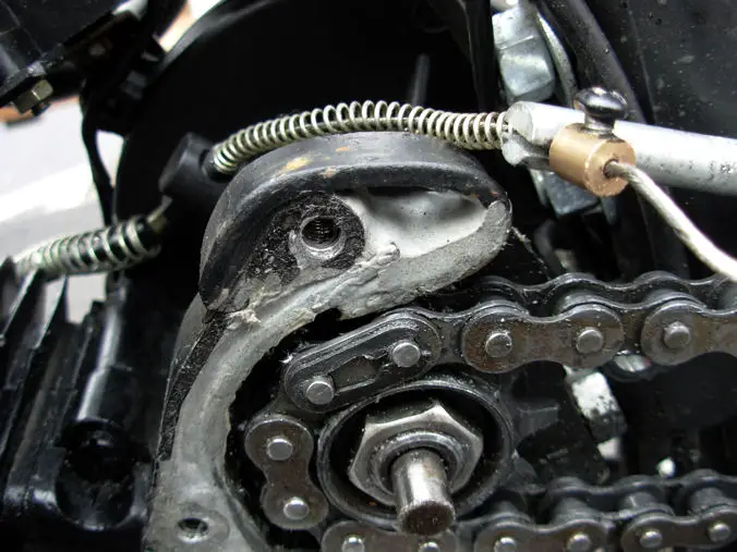

I had this problem when I first completed my build. I nearly broke my ankle with the full force of my weight on the down stroke on the pedal when the wheel locked up. I ended up falling over onto the ground rolling in the pain from a badly spained ankle.
Anyway, I came up with a solution that involved some work. I took a couple of pieces of 1/2" X 1/8" bar steel and formed a somehwat rounded chain guide around the small sprocket. I used JB Weld to glue the steel into place. This solution doesn't allow the chain to jump off the sprocket.
I suspect the reason I had this issue in the first place is because of the rear suspension on my bike.
See attached pics for clarity.
James.

Turns out it was the master chain link that was stopping it from moving as there was a extra piece on it that made that link thicker then it should of been. I had not noticed this at all till my gf figured it out and pointed this out to me..

Finally the JB weld did NOT hold. The engine heated it up and made it very soft and you can peel it off with your fingers..

So far the JB weld is holding. I've had the carb loosen up on me but I think it was a combination of the vibration and the bike fell over onto the air filter. I reattached it to the intake manifold with a screw and a lot more JB Weld.
