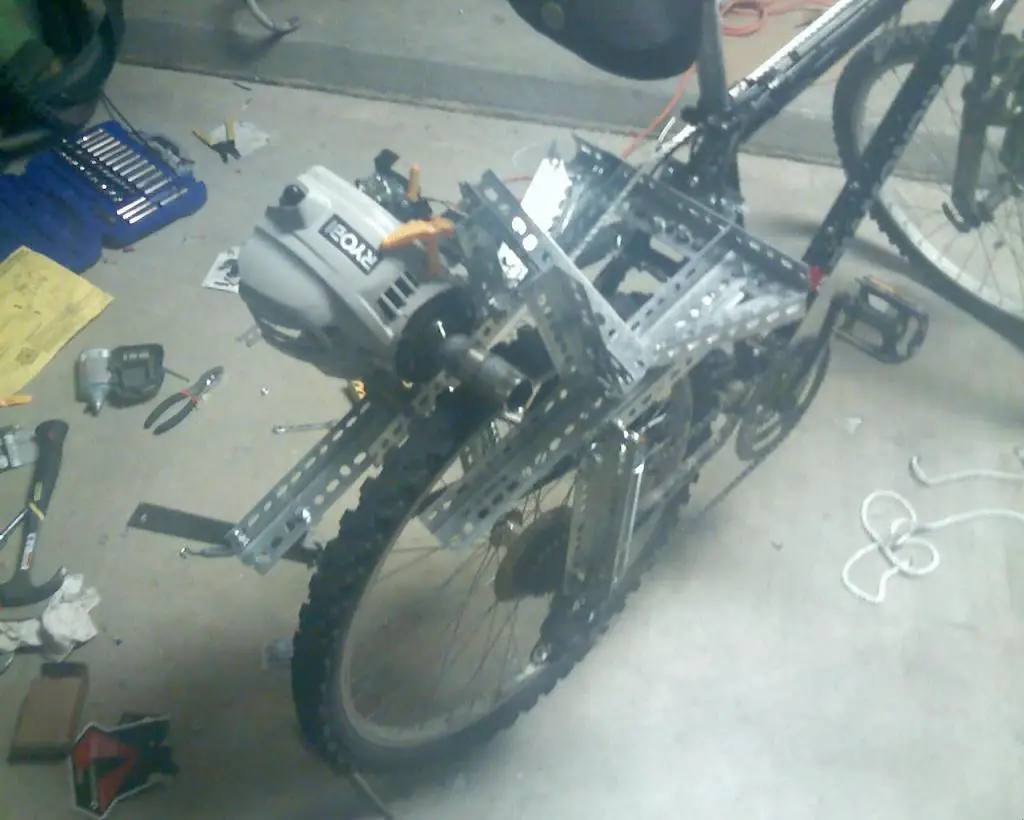

Thanks for the quick reply Deacon... I was surprised that the hardware store had left handed nuts too, and they even had the size i was looking for...Only to find out it didn't fit anyway :-( I'm guessing the shaft is 3-4 inches but I'm not exactly sure...Here is a quick picture i took with my phone after i was done...Better quality pictures will come soon.

I got to tell you that I love that frame you built reminds me of an erector set I had as a kid. I'm serious I do love that look.

Thanks for the compliment Deacon. It does look like an erector set doesn't it?!?
