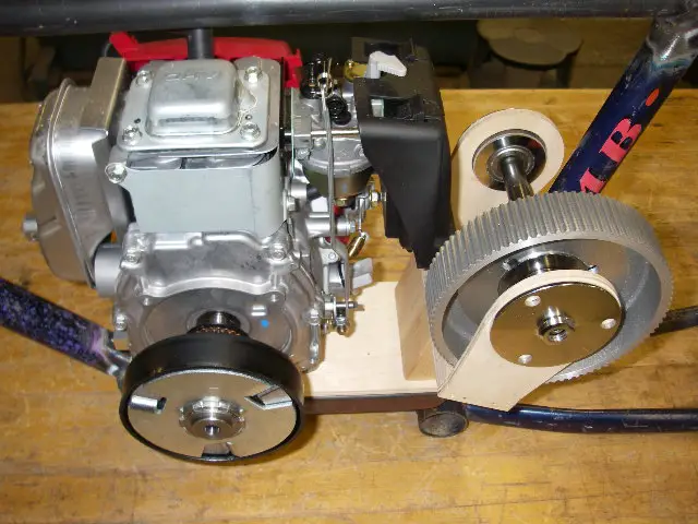

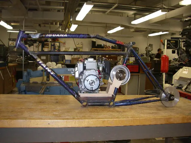

I'm talking about avoiding the gearbox all together. Using a Jackshaft instead. I'm currently working on the setup shown below using Metric Timing Belts, but you could do something similar using chain or V-Belts, and save yourself all the problems that the various gearboxs and cheap chinese clutches are causing the owners of these chinese kits.
ocscully
ocscully
American ingenuity.
I love it ... I think.
Have you tested it?
Will you be selling them?
How much?
ricland

is that 2 frames welded together? Do you have a thread for this build? We need to watch this one
