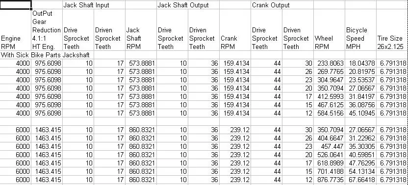

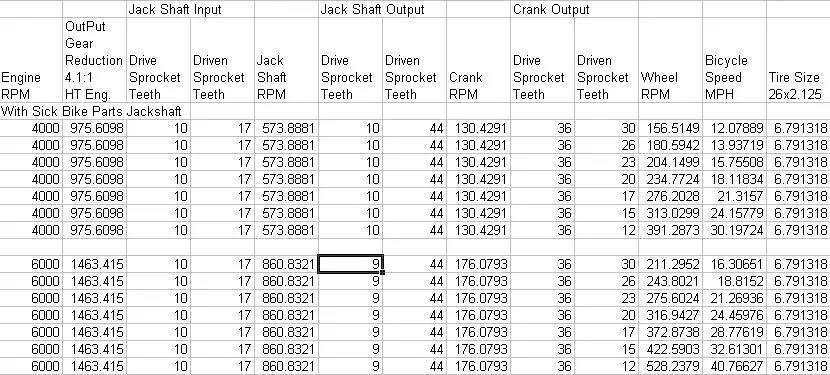

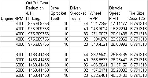

I developed a calculator in excel to see cause & effect on speed of tooth changes. My main goal is to examine the stock Sick Bike Parts jackshaft to include it in my project and see how it would work out on an existing 7 speed cassette and how it best relates to a NuVinci hub. Made one to show the basic HT install also. Tried to attach as a single page 30kb .pdf, but the forum limits are too small. Had to use .jpg instead. Can't attach as an .xls file either. :( If any one notes any errors, omissions or updated information, please post it.

That is really cool. I use ratiocalc.exe for my calculations.
I would like to see or use your spreadsheet with other wheel sizes and clusters.

Wow.. 67 mph using the jackshaft setup. Thats given infinite horsepower, zero wind resistance and no friction though. ;)
Nice spreadsheet though. is that calculated using diameter of a standard cruiser/MTB tire?
wildemere, here you go as a .zip The jackshaft values of .000001 are hidden on the HT sheet. Had to do that to eliminate a divide by zero error and I made the book for the jackshaft first.(^)
datz510, Yes, I found metric circumference tables for bike tires on line, applied a formula to that table to gain circumference in feet. The table is included in the workbook as a separate worksheet.

:eek: Aplologies to all. My Bad! I had the front two chainwheels that SBP provides inverted in the jackshaft formula's, hence the ridiculous speeds. Attached is corrected.
