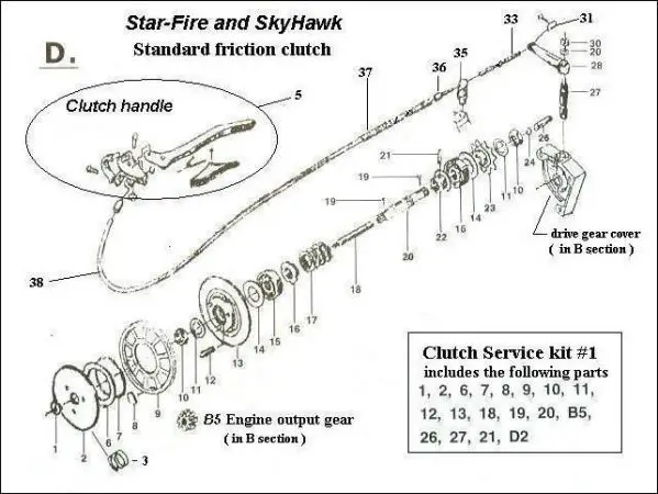

Actually, that sounds like a good idea with the very small exception that the whole shaft packed with grease may make the bike minutely harder to pedal, engine off.
Look at this-

the mount for the clutch cable at the base of the engine can be removed and grease shot into the hole which will pack grease into the shaft cavity and will also force grease out through the bearings the draw back is if you over do it grease will build up behind the clutch and can get into the clutch.
you can press out the mainshaft and repack the bearing and reinstall. I show the process in the total engine tear down post.

Norman, your tear down manual was a big help. I didn't know the clutch cable mount went all the way through. That sounds better than the grease zerk idea.
Grease on the clutch is no biggie, 10 minutes and some brake cleaners.
I'm try to avoid pressing out the bearings. I'll post the results.
