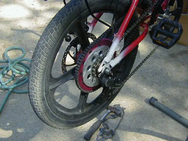

here are a couple pics of it on my bikes:
Now regarding your question...I don't think you have room to run a casset & 2freewheels. we did a project to broach White industries "eno's" to allow putting 2 freewheels on a casset hub.This gives total isolation of pedals from motor. But unless you can modify a casset cog set to 5/8" or so (3 gears max) you are stuck with singe speed for the pedal side of the drive trane.

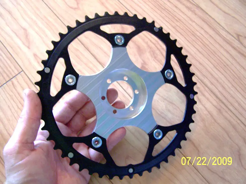

I prefer motor drive and manual pedal drive lines to be on seperate sides. Forum member Recumpence sells a disk brake sprocket adapter that allows for mounting of large sprockets AND still use the disk brake. You then run a freewheel on your motor output instead of having freewheels on the rear. IMO only it looks lil cleaner and less cluttered, i'm more about the looks than my buddy Thudster, he ain't a big a w a n k e r as me hehehe...
KiM

Hi,
Do you have a link to that part?
I have been unable to find it anywhere.
Lots of new information, but no part for sale.
Thanks,
PM Recumpence (Matt) Either on this forum or Endless Sphere forum and place an order, there is no 'link' to buy one, Matt is the man when it comes to components for rc motored e-bikes, he makes reduction drives, mounting hard ware for them, slipper clutches etc etc My cruiser runs one of Matt's single stage reduction drives and CnCed chain cover. He has a rock solid reputation on the Endless Sphere forums where he is avery active member, you wouldn't find a single person un-pleased with Matts work, I'ts impeccable and very well priced for components of such highly quality and standard of finish, i believe IIRC the sprocket adapter is only $US50 plus freight.
Kings Sales and Service groups also do Super Sprockets and Top Hat Sprocket Adapters. They are alot more pricey and IMHO not as good as what Matt makes.
I have attached pictures of the disk brake sprocket adapters, for a lil extra i believe you could get them in anodized finish also...
