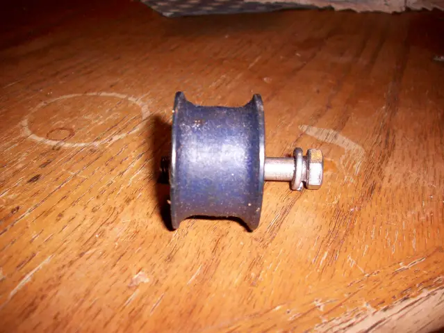

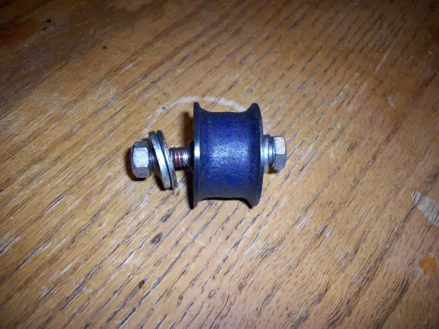

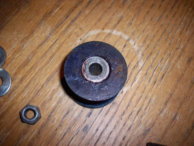

I only have one sheet metal screw in mine....the pic above is Norman's and he used a bolt and a screw.
I have not changed it yet but I did make one out of a MC chain roller and took the bench grinder so the chain would sit in better. So far my stock is working fine but I always make extra parts so when I need them.
ID:	1697   Click image for larger version
ID:	1698   Click image for larger version
