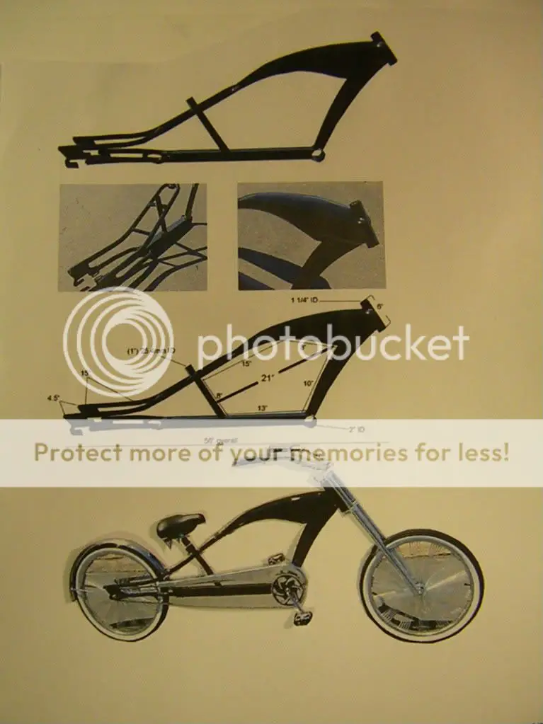

I'd suggest a Stretch Cruiser from Bicycle Designer or ChoppersUS, the one Bicycle Designer sell's has a square bottom tube which would allow an easy setup for bolting a steel plate to which you could then bolt your engine to, you did say you don't want to do any welding.

Here's a pic of the square bottom tube Stretch Cruiser offered by Bicycle Designer'

"STRETCH Cruiser Tank frame" from Bicycle Designer looks good and square bottom tube is a brilliant idea too. But, will the "fake" tank be in the way of the real tank?

DD, I don't know how you can mount the Chinese cloned Honda horizontal 4-stroke 50cc ATV / Dirtbike / Pitbike engine to a round tube maybe RedB66's motor mount clamps he use's on his Stretch Cruisers might work on a round bottom tube frame.
I'd recommend getting the Square tube frame Stretch Cruiser from Bicycle-Designer, since it would offer you the easiest way to mount the skid plate to the frame, and then just bolt engine to the

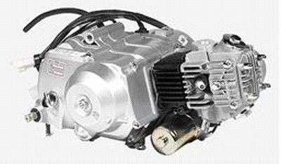

Hey steve, for the price and the quality I'd go for Honda
But look at this:
It looks so cool!!!
Has anyone have Lifan 50cc engine's dimension? I dont think the dimension on tbolt's website is accurated because the 50cc to 110cc's dimension is the same...

16" L x 12"W x 9"T give or take 1/4" or so, not including carby, mounts, manifolds or chain clearances (49.5cc auto clutched three speed, electric start) ;)
