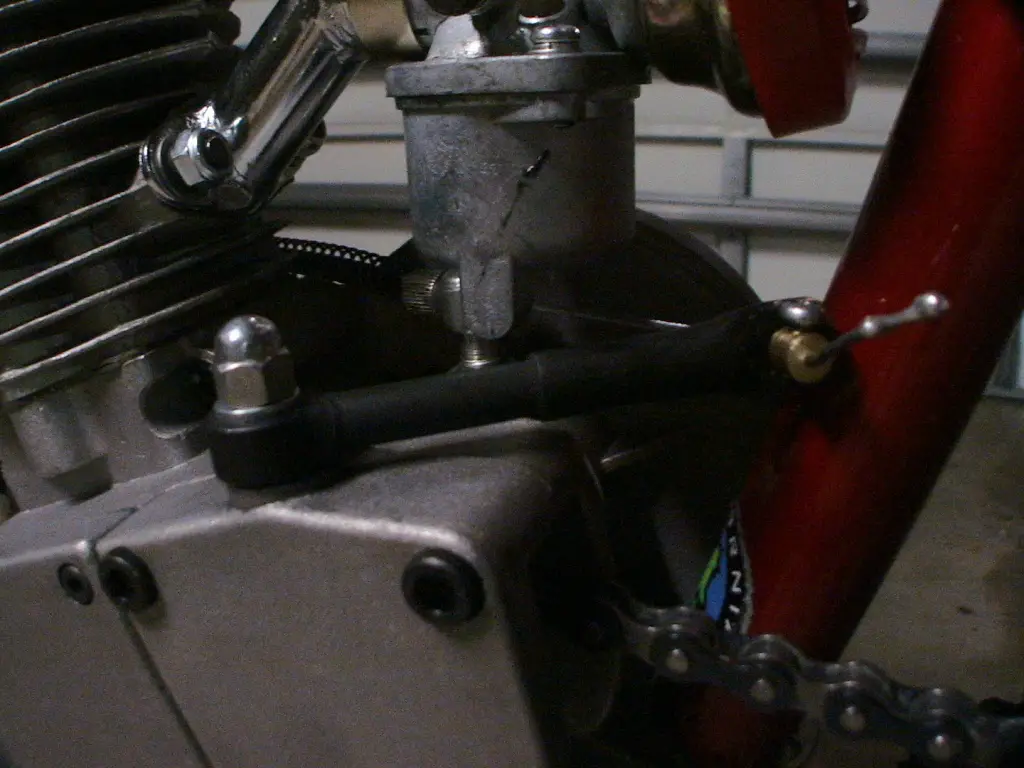

I also would suggest the tensioner, as well as the #41 chain, sooo much better than the stock parts...And what I did for the clutch is to just lengthen the clutch arm and turn it inwards for a more direct pull, as well as replace the junk stock cable and clutch lever....
